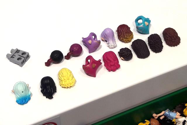

Here's also the picture I took in Billund of all the rubber parts I got my hands on:
Please compare with the 10000 range we added (not considering the shades of dark brown as they are to subtle).
w.

(2019-06-04, 13:26)Willy Tschager Wrote: Here's also the picture I took in Billund of all the rubber parts I got my hands on:
I tried to match every part with existing color. The only that doesn't match is this one, missing a medium lavender rubber color:
Attached Files Thumbnail(s)

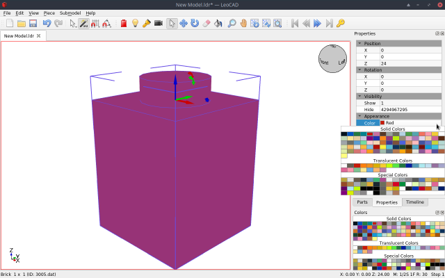

LeoCAD also can't handle LDConfig 2019 colours with ID larger than CODE 512. UPD: Seems like LeoCAD could import new "LDConfig.ldr" placed in "Custom parts library" folder, where LDraw parts stored in un-zipped form.
[Image: yTqWAG0.png]
But LeoCAD CAN'T import "ldconfig.ldr" placed in same folder where ZIP of "Custom parts library" stored. [Image: FBPAhWN.png]
Hope, Leonardo Zide could fix it soon.
Reply

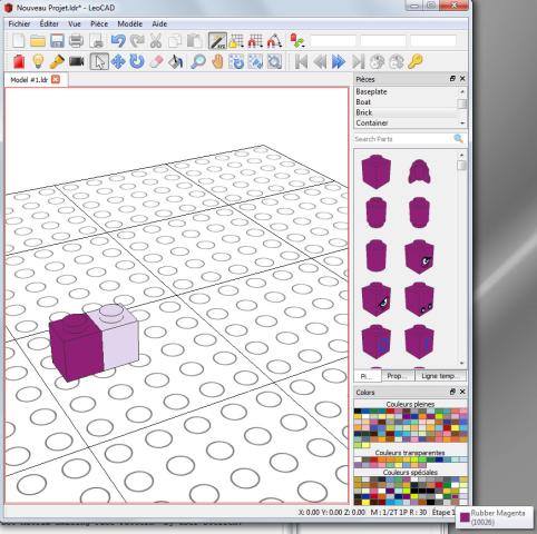

(2019-06-16, 12:04)Eugen Wrote: LeoCAD also can't handle LDConfig 2019 colours with ID larger than CODE 512. Hope, Leonardo Zide could fix it soon.
Mmhhh.... seems to work perfectly here (Windows version 17.07)

(2019-06-11, 15:01)Philippe Hurbain Wrote: LeoCAD and LDView work fine.
LeoCAD has some issue

#30
(2019-06-16, 12:29)Philippe Hurbain Wrote: Mmhhh.... seems to work perfectly here (Windows version 17.07)
Well, could you describe how you add 2019 version of LDConfig.ldr to LeoCAD 17.07 on Windows?
Also, could you reproduce it with latest nightly build of LeoCAD? FTR, I tested it with LeoCAD nightly build under Linux — and it CAN'T import colors from 2019 version of LDConfig.ldr (I renamed it to ldconfig.ldr according LeoCAD behavior for import 3rd-party LDConfig files):
Reply
RE: Updated LDConfig.ldr file
#31
(2019-06-16, 13:28)Eugen Wrote: Well, could you describe how you add 2019 version of LDConfig.ldr to LeoCAD 17.07 on Windows?
I did nothing, just updated the ldconfig.ldr in my LDraw folder (I use a plain LDraw library, not the zipped one provided with LeoCAD (view -> preference -> custom library)).
Quote:Also, could you reproduce it with latest nightly build of LeoCAD?
No I can't install it. It uses a DLL missing from my ageing system (tried to install it in the past, but failed, known problem).
Reply
#32
(2019-06-16, 13:54)Philippe Hurbain Wrote: No I can't install it. It uses a DLL missing from my ageing system (tried to install it in the past, but failed, known problem).
Could you link related issue? Or if this not reported yet, please, create one.
Reply
#33
(2019-06-16, 14:28)Eugen Wrote: Could you link related issue? Or if this not reported yet, please, create one.
Well, technically it's not a problem with LeoCAD but with my system (I do have the same problem when I try to install other programs). The DLL is api-ms-win-crt-runtime-l1-1-0.dll
Reply
#34
(2019-06-16, 14:33)Philippe Hurbain Wrote: Well, technically it's not a problem with LeoCAD but with my system (I do have the same problem when I try to install other programs). The DLL is api-ms-win-crt-runtime-l1-1-0.dll
That's a visual c runtime dll, the leocad installer should include the version that comes with the compiler used.
Reply
#35
(2019-06-16, 18:56)Roland Melkert Wrote: That's a visual c runtime dll, the leocad installer should include the version that comes with the compiler used.
Thanks for details! I just reported it LeoCAD devs
Reply
#36
(2019-06-16, 19:45)Eugen Wrote: Thanks for details! I just reported it LeoCAD devs
Thanks guys. Nonetheless, I should be able to install this DLL through Windows update, but I cant Sad
Reply
#37
(2019-06-17, 5:26)Philippe Hurbain Wrote: Thanks guys. Nonetheless, I should be able to install this DLL through Windows update, but I cant Sad
You probably need to install the vs redistributable from https://support.microsoft.com/en-us/help...-downloads
I'll add the missing dlls to the installer.
Reply
#38
(2019-06-17, 5:39)Leonardo Zide Wrote: You probably need to install the vs redistributable from https://support.microsoft.com/en-us/help...-downloads
Yes, that's the one that doesn't install (remains forever at "initialization" state) Sad Something broken here...
Reply
#39
(2019-06-16, 13:54)Philippe Hurbain Wrote: I did nothing, just updated the ldconfig.ldr in my LDraw folder (I use a plain LDraw library, not the zipped one provided with LeoCAD (view -> preference -> custom library)).
Thanks for details! Just updated my comment above: Think, I found a way to reproduce issue with loading "ldconfig.ldr" placed in same folder where ZIP of "Custom parts library" stored. Here is issue report:
Reply
