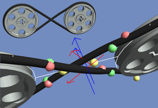

I have gotten through your tutorial doc. I have a basic understanding. I've been modeling rubber belts with success, THANK YOU very much. I actually need to make a figure 8 to go around two 1/2 bushes. In fact, the "x" section of it has to currve outside of 1 beam. Yah, it's kind of a fussy job. The figure 8 is what I really need the most help wiith. I accidently got an X when I was initially learning this. But, I don't know how it happened. Thanks for your help. This little job is the reason I began the LDCAD tutorial.
(2018-09-08, 2:25)Kathleen Kampf Wrote: I have gotten through your tutorial doc. I have a basic understanding. I've been modeling rubber belts with success, THANK YOU very much. I actually need to make a figure 8 to go around two 1/2 bushes. In fact, the "x" section of it has to currve outside of 1 beam. Yah, it's kind of a fussy job. The figure 8 is what I really need the most help wiith. I accidently got an X when I was initially learning this. But, I don't know how it happened. Thanks for your help. This little job is the reason I began the LDCAD tutorial.
You can make a cross by reversing one of the two circle guidance points wrapping direction. This is done by editing its properties (enter while selected, or click the coordinate panel).
But if you are a perfectionist this might not be good enough as the band will physically cross itself.
You can improve that by positioning a couple of extra bezier guidance points like in the below image.
(2018-09-08, 18:28)Roland Melkert Wrote:(2018-09-08, 2:25)Kathleen Kampf Wrote: I have gotten through your tutorial doc. I have a basic understanding. I've been modeling rubber belts with success, THANK YOU very much. I actually need to make a figure 8 to go around two 1/2 bushes. In fact, the "x" section of it has to currve outside of 1 beam. Yah, it's kind of a fussy job. The figure 8 is what I really need the most help wiith. I accidently got an X when I was initially learning this. But, I don't know how it happened. Thanks for your help. This little job is the reason I began the LDCAD tutorial.
Thanks, I tried this today. I was able to form my figure 8 but, part of it appears flat like tape and another portion looks wrinkled. I am happy it's twisted now.

(2018-09-21, 19:51)Kathleen Kampf Wrote: Thanks, I tried this today. I was able to form my figure 8 but, part of it appears flat like tape and another portion looks wrinkled. I am happy it's twisted now.
You need to make sure the 'roll' orientation is correct when using the bezier points. It's indicated by the red/blue arrows. The difference between two connected ones should be less then 180 degrees or the underneath math will do funny things

(2018-09-26, 12:31)Kathleen Kampf Wrote: I don't understand 'roll' orientation nor how to use the bezier points.
Roll influences the orientation of the band while it goes around the wheels. It causes the twist you describe when configured wrongly. This can happen ether by wrong orientation of bezier points or by high values for the roll field in circular points.
If you share the model I could take a look at the problem as I'm not completely sure what you are trying to do.

https://bricksafe.com/pages/1963maniac - "Didumos Sequential 8 Speed Transmission..." That is my file that I've been working on. The O rings are a little goofy. They are located and wrapped around the 1/2 bushes properly. But, they have flat portions and wrinkles. There are 4 of them. Thanks for taking a look.
RE: LDCAD compass location
2018-10-03, 14:00 (This post was last modified: 2018-10-03, 14:01 by Philippe Hurbain.)
(2018-10-03, 12:04)Kathleen Kampf Wrote: https://bricksafe.com/pages/1963maniac - "Didumos Sequential 8 Speed Transmission..." That is my file that I've been working on. The O rings are a little goofy. They are located and wrapped around the 1/2 bushes properly. But, they have flat portions and wrinkles. There are 4 of them. Thanks for taking a look.Here we are... (attached)
I modified one of the rubber bands, I let you do the other one as an exercise
(you can probably use only one rubberband shape, as setup is symmetrical). What I had to do was to
- Rotate the second path point by 180° to eliminate the squishing effect.
- This also uncross the rubber band, so I had to take properties of the path point and change it from clockwise to counter clockwise
- Add two Bezier path points at the crossing to avoid self-penetrating band.
- Also had to adjust control points, as the path points were very close to each other the shape was very angular.
- Finally, adjusted the Bezier path points positions to avoid collision with the black beam 1L
See also this thread https://forums.ldraw.org/thread-22945-po...l#pid29464 that describes a very similar problem.
(2018-10-03, 14:00)Philippe Hurbain Wrote: Here we are... (attached)
You might also want to change the band's skin to allow for smoother curves by changing "basesize" from 400% to 200% as its a very small band.
