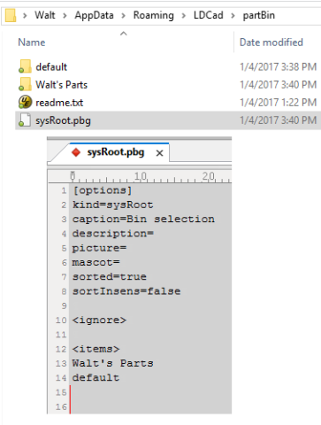

The EV3-Edu kit consists of a tub with the large parts, plus a red tray with thirteen bins for the small parts and a guide to which parts should go in which bin.  We want each of our six LDCad part bins to be one or more of these bins.
On a Windows 10 system, the image below shows where the LDCad 1.5 "partbin" folder is located, under C:\Users\Walt as shown.  The LDCad 1.5 installation creates and populates the "default" folder.  We don't want to change the "default" folder because it might be overwritten by LDCad upgrades.  We want a parallel folder with a person's name so it's clear that it isn't part of the official installation.  I chose to name it "Walt's Parts."
Edit the "sysRoot.pbg" file to add "Walt's Parts" as shown.  When you launch LDCad 1.5 and click the up arrow in the Bin Selection window, you will now see pictures corresponding to each of the two folders.  LDCad 1.5 goes into those folders and finds corresponding images (described below) to make the selection choices clear.  This pattern will repeat in the examples below:  LDCad 1.5 opens things listed in <items> to locate pictures to associate with those items.
Walt

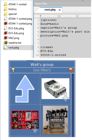

For Beginners: LDCad 1.5 Part Bins for EV3 Education 45544-1, Part 2 of 6
Each folder under "partBin" needs a "root.pbg" file.
Looking at "root.pbg" in the "Walt's Parts" folder, note the "picture=Me2.png" image reference which was used by LDCad 1.5 to associate this folder with a recognizable image in the screen shots above as specified in the "sysRoot.pbg" file.
The "root.pbg" file is shown below.  Note an important difference between this "root.pbg" file and the "sysRoot.pbg" file shown above:  sysRoot.pbg <items> are folders, while root.pbg <items> are someName.pbg filenames without the ".pbg" extension.  The fact that there is a "45544-1-sorted" sub-folder is of no concern to this "root.pbg" file.  It's only looking for ".pbg" files to process.
The LDCad 1.5 result of this "root.pbg" file is also shown.  Each of the "root.pbg" <items> has an image using the same name.  There's an image "EV3-EDU.png" of an EV3 brick and LDCad 1.5 found a part bin group "EV3-Edu.pbg", so LDCad floats a down arrow over the image.  Same with "45544-1-sorted.png" and "45544-1-sorted.pbg."  Edit note: since original posting, I added a third part bin group so there is an extra image.
For our first goal of a single part bin with all the parts in one bin, EV3-Edu, we are done with the folder configuration work.  The contents of "EV3-Edu.pbg" finishes that first goal as shown in Part 3 next.

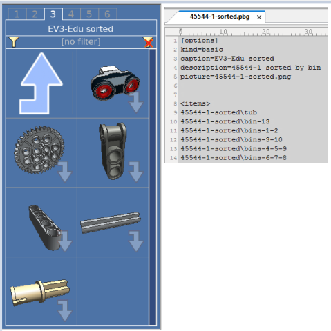

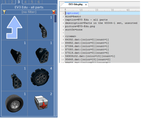

For Beginners: LDCad 1.5 Part Bins for EV3 Education 45544-1, Part 3 of 6
The image below shows what happens when you click the EV3 brick image and LDCad processes the "EV3-Edu.pbg" file.  The Bin Selection window populates with the <items> from the "EV3-Edu.pbg" file which is also shown below.  Note the picture reference to the "EV3-Edu.png" image which was used by "root.pbg."  I chose "sortOn = none" because I wanted to list the parts in the same order that the sorted bins will come in.  But you should experiment with other options if you are more comfortable with other arrangements of the parts.  Just remember, it's all one LDCad part bin.
Also shown are the seven lines from "EV3-Edu.pbg" that correspond to the parts shown in the LDCad 1.5 Bin Selection screenshot.  Each line references an LDraw ".dat" file which is used by LDCad to generate the image, plus the color information for the color of the part used in the EV3 kit, plus the count of those parts in the kit, which shows in the upper right corner of the image for each part.
The "45544-1-sorted.pbg" file is for the second goal of having six LDCad part bins that sort the parts by type, described next.
Walt

For Beginners: LDCad 1.5 Part Bins for EV3 Education 45544-1, Part 4 of 6
In the screenshots below, we're still in the "Walt's Parts" folder, now looking at "45544-1-sorted.pbg."  It's the same pattern as before.  Note the "picture=45544-1-sorted.png" line that displays the red tray as a clue that this is for the sorted bins, as used by the "root.pbg" file.
In this file, the <items> are filenames without the ".pbg" file extension.  And as before, LDCad gets the images shown for all six ".pbg" files by opening what it finds listed in <items>.  For example, LDCad finds "tub.pbg" in the "45544-1-sorted" sub-folder and within "tub.pbg" gets information for showing an image for that bin, in this case the image of the ultrasonic sensor.  And because LDCad found "tub.pbg" it floats the down arrow over the image of the ultarsonic sensor.
Walt

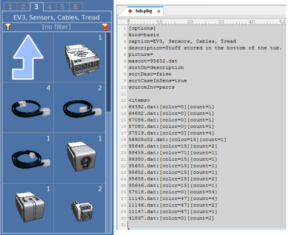

For Beginners: LDCad 1.5 Part Bins for EV3 Education 45544-1, Part 5 of 6
Finally, the contents of one of the six desired part bins, this one "tub.pbg."  For this file, the "picture=" line has no entry.  Instead, LDCad 1.5 provides the "mascot=" feature, which allows you to specify one of the <items> and LDCad will use that item's LDraw ".dat" file to generate the image chosen to represent all the items.  "95652.dat" is the LDraw file for the ultrasonic sensor.
In this same manner, the six ".pbg" files allow the one hundred types of LEGO pieces in EV3-Edu to be subdivided by type; in this bin you only have to sort through eighteen pieces to find what you are looking for, and it is already in the correct color.
Walt

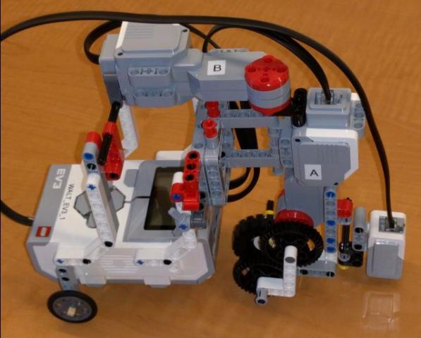

For Beginners: LDCad 1.5 Part Bins for EV3 Education 45544-1, Epilog
Having the part bins set up made the learning curve for LDCad a lot easier.  I then figured out how to use LPub3D.1.3.4 to generate the building instructions I wanted.
The robotics students study line/edge following using the standard robot described in the EV3-Education kit which has "wheelchair" steering with one motor on each side.  Students who finish that challenge early are going to be given a different configuration robot:  a front motor assembly that drives the robot and a sideways mounted motor to steer by turning the whole front assembly.
The robot only uses one piece that isn't part of the EV3-Edu kit: a thin wheel with a hard rubber tire that I can buy at BrickLink for about $0.25.  It's part 3482c03.
LDraw file generated by LDCad 1.5 and building instructions below.
Building Instructions
Walt
