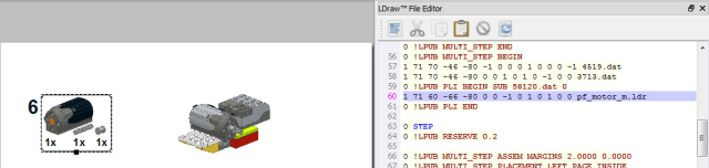

I've come up with a strange issue. I'm trying to show a simple M-Motor instead of motor+cable assembly file and for some reason, even though the surrounding parts are all grey, the motor turns up black. Any idea what may be going on?
Code:
0 !LPUB MULTI_STEP BEGIN 1 71 70 -46 -80 -1 0 0 0 1 0 0 0 -1 4519.dat 1 71 70 -46 -80 0 0 1 0 1 0 -1 0 0 3713.dat 0 !LPUB PLI BEGIN SUB 58120.dat 0 1 71 60 -66 -80 0 0 -1 0 1 0 1 0 0 pf_motor_m.ldr 0 !LPUB PLI END

#8
'cause you set the substituted part in color 0 = black Wink
should be
Code:
0 !LPUB PLI BEGIN SUB 58120.dat 71
Reply
Re: Hiding parts from the part list in LPUB
#9
D'oh!
I saw the 0 the first time I used the command and never thought about what it might mean. I used it for string, which is black, so of course not worked. Philo to the rescue again Smile
