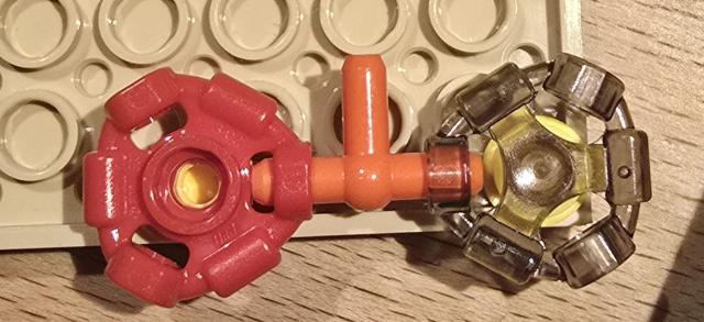

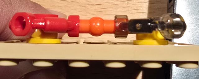

If you put the file I attached like this:
Code:
1 11 0 -1 0 1 0 0 0 1 0 0 0 1 20612-db.dat
1 14 0 0 0 1 0 0 0 1 0 0 0 1 20612-bi.dat
1 9 0 8 0 1 0 0 0 1 0 0 0 1 1941.dat
1 10 0 -1 0 1 0 0 0 1 0 0 0 1 20612.dat
the perpendicular bar holes are at the same level.
this is what I mean with the same geometry. (function of the perpendicular holes)
- in 20612 you can insert the bars further in than in 1941
- 1941 hat a throughhole and an antistud.
as I got both with me, I can hardly see if there is a difference in the vertical location of those bar-holes (i.e. this 1 LDU)
Attached Files Thumbnail(s)

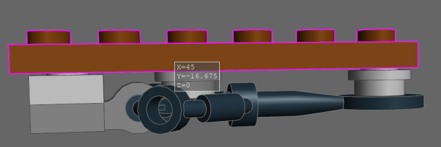

And what about these assemblies where I see a 0.675 height discrepancy?
