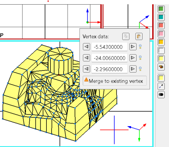

(2024-11-05, 13:32)Jasper Speelman Wrote: Apparently there's a lot of invalid lines but I'm not sure what is invalid exactly.... I added some of the metadata but it seems to be the rest causing problems... can someone help me figure it out?
Also x351 is apparently not supported, so I changed it to the alternative part number 41850.
Nice work there! I really like to finally have this part available Smile
Regarding the errors, most of it seems to be caused by the usual Stud.io export mess-ups. It can be very easily fixed in LDraw Parts Editor (at least it seems so).
The meta data should look something like this:
0 Body, Racers Driver
0 Name: 41850.dat
0 Author: Jasper Speelman [JappaWakka]
A few more issues I found thus far:
*edge lines (Line Type 2) should be reworked, there are a few missing or misplaced I would say
*Conditional Lines (Line Type 5) are missing entirely, those are needed to make the round areas look 'smooth' (use Edger2, then manually check for errors)
*many triangles could be merged to quadrilaterals (use Rectifier from LDPE)
*the neck connector pin should probably be replaced by a cylinder primitive
Most of this can be done with LDraw Parts Editor (LDPE):
https://sourceforge.net/projects/partcreator/
br, Chris

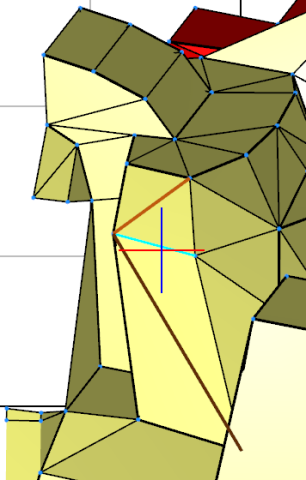

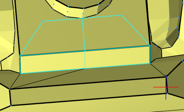

Another little nitpick would be the y-coordinate of the neck connector:
I would assume that this is meant to be 'in system', meaning the y-value should be exactly 24 LDU not 24.006 LDU.
This would apply to the entire flat 'neck' area. Did you measure this value yourself?
Unfortunatley I can not access one of mine to compare at the moment Confused
Reply
RE: Part x351 (41850) - Body, Racers Driver
#7
(2024-11-05, 14:09)Chris Böhnke Wrote: Another little nitpick would be the y-coordinate of the neck connector:
That's a valid nitpick, I didn't measure stuff because blender doesn't measure things in ldu.

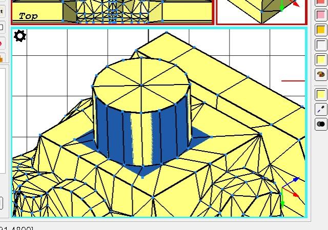

1) Delete the existing cylinder geometry (but remember the actual position)
2) Cylinder primitives are set with their origin in the center top, so enter the original coordinates as the first 3 values, in your case this would be: 0 -32 0 (with the height accuracy already adjusted)
3) The first and third triplet of values afterwards change the radius (default is 1 LDU). Since you want a radius of 6, this gives 6 0 0 and 0 0 6 respectively.
4) Finally adjust the height in the second triplet: 0 8 0
Using the 4-4cylc primitive (full 360° cylinder which has top but no bottom surface and edges on both ends) gives you this line:
1 16 0 -32 0 6 0 0 0 8 0 0 0 6 4-4cylc.dat
The official documentation on primitives can be found here: https://wiki.ldraw.org/wiki/Primitives_R...ensional_2
While it's probably not 100% necessary for this part, I would still advise to use a matching "anti-circle" at the bottom around it, to avoid T-junctions and gaps:
1 16 0 -24 0 6 0 0 0 1 0 0 0 6 4-4ndis.dat
You would then have to realign the remaining vertices to this new square (including the mid points!)
You can then repeat this process for the underside of the pin Wink

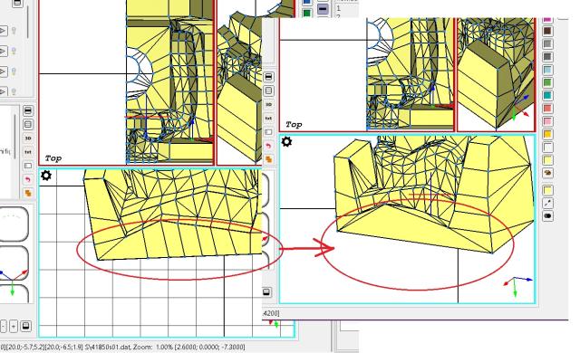

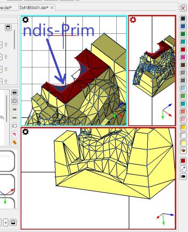

Chris Böhnke, I can't make any sense of this LDPartEditor tool. It's the most confusing 3d software I've ever seen. I don't think I can reliably use this.
I did figure out a way to have a better, more clean export from Blender using the ExportLDraw addon, which I've included in the attachments.
It already has the lines (although I can't find a way to add a conditional line myself) and smooth shading set properly. I also made sure some key vertices are rounded to whole LDUs.
Could this be useful? I really need some help getting this right.

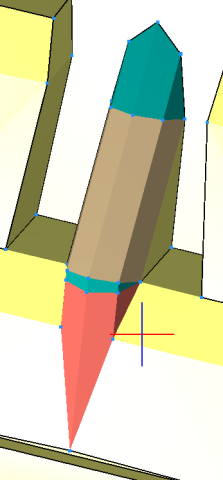

for the stud
instead of this
Quote:1 16 0 -32 0 6 0 0 0 8 0 0 0 6 4-4cylc.dat
do this
Quote:1 16 0 -28 0 1 0 0 0 1 0 0 0 1 studa.dat
1 16 0 -28 0 6 0 0 0 4 0 0 0 6 4-4cyli.dat

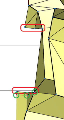

Quote:you should get rid of the center vertices of straight edges... (merge to other vertices)
and the LDraw specs use somewhat "ideal" values on connections, so look to get the outer corners to nice round values.
for example, the corners are at 16.048 and 20.06, try to get these to 16 and 20.
same for the "neck" connection point, instead of -24.072 use -24
to do that, try using the LDPE
I don't know what to do or how to do it. LDPE is unusable to me. Nothing works like it should and it's stressing me out.

(2024-11-11, 19:23)Jasper Speelman Wrote: I don't know what to do or how to do it. LDPE is unusable to me. Nothing works like it should and it's stressing me out.
thats normal, LDPE is somewhat of a homebrew (by Nils Schmidt, he is also here in the forum)...
some instructions for you:
.png   VertexMod.png (Size: 16.16 KB / Downloads: 377)
select a vertex (either by clicking it or drag open a rectangle)
then use Actions -> Merge to nearest Vertex
and it plops to the nearest one (if that one isnt the right one, undo and manually move it closer by editing the values)

I think what Rene means is something like this:
A single line should only have 2 vertices on it. You probably have to puzzle a bit to get this arranged correctly with the connecting geometry, but it should be possible. There might be a few exception an additional vertex is  unavoidable, but those shown can be merged for example.
Also you should rebuild the neck area using a primitive (blue) and then add new triangles (red):
(Please note there are still a few unneccessary vertices in this image that should be merged)
Hope this helps a bit.

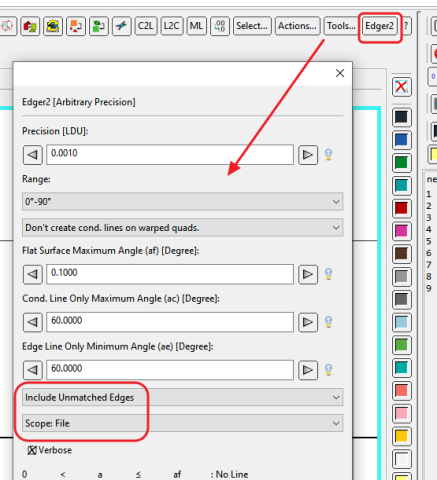

When you have all the surfaces the right way up I would recommend you to start figuring out an excellent tool called Edger2.
Now there are many (manually?) added condlines in your file which have bad control point.
This makes them show up to soon, or to late, and don't give the wanted result.
Delete all the condlines you have first. Add new ones with the tool.
Click on Tools.. and choose Edger2. This opens a menu of settings for the tool. All you need to start with are the 2 marked dropdowns.
If you choose Include Unmatched Edges the tool will add a red edge line where an edge line is missing.
Since you are working on a mesh divided in 2 halves it might be better to choose Exclude Unmatched Edges.
The other dropdown will set the scope for the tool.
Choose File if you only want to add missing lines in the file you're working on, or File+subfiles if you want the tool to search deeper in the part structure for missing edge and condlines.
Leave all the rest in default settings.
Click OK and the tool will add what is missing.
When you are satisfied with the settings you can use the quick button Edger2, next to the Tool.. menu, to trigger the tool to add condlines.
That button will use the settings from the Edger2 tool menu.

Finding surfaces to subfile is always good, but dividing flat quads into 2 symetrical halves is never good practice.
Here is an example of useless vertices that should be avoided.
Try to remove these surfaces from the subfile, and then add them in the top level as full quads, spanning from left to right side.
Reply
#31
(2024-11-19, 21:14)Magnus Forsberg Wrote: Finding surfaces to subfile is always good, but dividing flat quads into 2 symetrical halves is never good practice.
Actually, those vertices may be there avoid t-junctions where the base meets the top. (I can't tell for sure if this is true.) There is certainly reasonable debate about how much effort should go into avoiding t-junctions, but saying that they are useless is wrong if they do indeed prevent t-junctions.

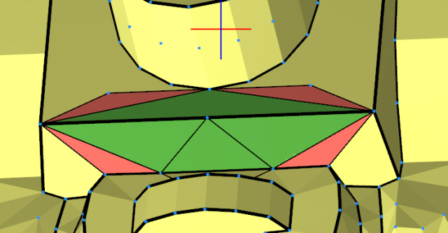

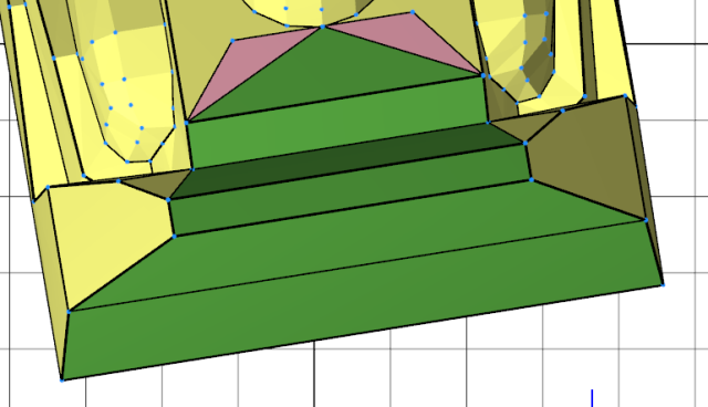

(2024-11-21, 15:24)Jasper Speelman Wrote: That would result in these part files (I made backups just in case)
It's not ideal when it comes to modeling, because it's not symmetrical....
But you can make them symmetrical...
You have already correctly found, and avoided a T-junction here, by adding a triangle and a quad:
But you should expand the search for symmetrical quads.
These are also divided:
Start at the cylinder. Split the surface into triangles. The pink triangle should be in the subfile, making the subfile symmetric.
All the green surface should then be in the main file.
Many more surfaces are divided in your part. I just made this to show an example.
Two symmetrical quad is equal to 4 triangles to render.
In my example the quads are replaced by 3 triangles. One less to render.

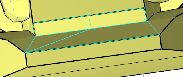

(2024-11-22, 9:23)Jasper Speelman Wrote: How is this?
Looks good, there's just one more quad near the neck in the front that could be converted.
Actually that would turn two quads into 3 triangles so I understand why you may not want to do that,
Reply

(2024-11-22, 17:31)Mark Kennedy Wrote: Looks good, there's just one more quad near the neck in the front that could be converted.
I couldn't find a good way to change those 2 quads without simply turning them into 4 triangles because otherwise you'd have a t intersection. I'll upload it to the part tracker soon then, if Rene is okay with those feet vertices. I would like feedback on the sides of the seat/legs because I didn't know if they needed to be angled the same as the feet and back of the seat.

(2024-11-22, 18:09)Jasper Speelman Wrote: I couldn't find a good way to change those 2 quads ......
Try this:
.. and you can remove one triangle.

(2024-11-22, 18:40)Magnus Forsberg Wrote: Try this:
Yeah that triangle in the center can be removed because otherwise you'd have a vertex halfway on a straight line. I'll fix it later. Thanks Smile

Hello: allow me to introduce a pic that show some arrangements to this part
The colors 11 and 12 are in the subfile, and color 19 in main file.
If you do it be warned to modify the subfile accordingly.
It's only a suggestion; others may or may not concord.

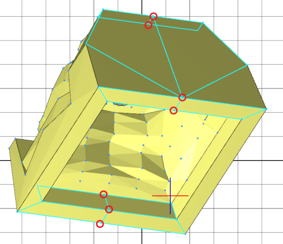

Hello: a pic showing one of the unmatched vertices. It is on the shaft,
.png   Unmatched vertices.png (Size: 1.9 KB / Downloads: 88)
Also, I post my code of the shaft (from the above post):
Goes in subfile:
Code:
4 16 9.446 -17 -19 7.536 -8.479996 -18.4344101 6.425 -3.524 -19 6.425 -3.524 -19.762
4 16 7.536 -8.479996 -18.4344101 9.446 -17 -19 9.05799 -15.269 -15.933 7.98 -10.461 -17.106
3 16 0 -19.714 -13.607 1.06065 -18.610758 -13.607 3.534 -19.983 -13.607
3 16 1.06065 -8.480996 -18.4344101 4 -10.461 -17.106 1.5 -10.461 -17.069
4 16 4 -10.461 -17.106 1.06065 -8.480996 -18.4344101 7.536 -8.479996 -18.4344101 7.98 -10.461 -17.106
4 16 1.06065 -8.480996 -18.4344101 0 -3.701 -19 6.425 -3.524 -19 7.536 -8.479996 -18.4344101
4 16 3.643 -21.517 -13.607 1.799 -22.212 -13.607 0 -22.483 -13.607 0 -19.714 -13.607
4 16 0 -19.714 -13.607 3.534 -19.983 -13.607 4.654 -20.133 -13.607 3.643 -21.517 -13.607
4 16 1.5 -10.461 -17.069 4 -10.461 -17.106 4 -10.46 -13.607 1.5 -10.46 -13.607
4 16 1.06065 -18.610758 -13.607 1.5 -15.947385 -13.607 3.263 -17.452 -13.607 3.534 -19.983 -13.607
4 16 3.263 -17.452 -13.607 1.5 -15.947385 -13.607 1.5 -10.46 -13.607 4 -10.46 -13.607
1 16 0 -10.461 -17.069 1.5 0 0 0 6.76 0 0 0 -1.931 8\1-4cyls.dat
3 16 1.06065 -10.461 -18.4344101 1.5 -10.461 -17.069 1.06065 -10.892331 -18.4344101
4 16 1.06065 -10.461 -18.4344101 1.06065 -10.892331 -18.4344101 0 -11.071 -19 0 -10.461 -19
3 16 1.06065 -16.378716 -14.9724101 1.5 -15.947385 -13.607 1.06065 -18.62889794 -13.607
4 16 0 -19.714 -13.607 0 -16.557385 -15.538 1.06065 -16.378716 -14.9724101 1.06065 -18.62889794 -13.607
Goes in main file:
Code:
3 16 6.425 -3.524 -19 0 -3.701 -19 -6.425 -3.524 -19
4 16 6.425 -3.524 -19 -6.425 -3.524 -19 -6.425 -3.524 -19.762 6.425 -3.524 -19.762
1 19 0 -15.947385 -13.607 -1.5 0 0 0 5.48639 -0.61 0 -3.462 -1.931 8\2-4cyli.dat
If you use the codes, you can delete some conditional lines.
But as before, these is a suggestion; you are the author of the part.
Reply

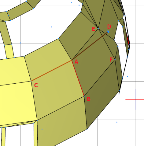

#48
Can I assume you understand what a condline is?
An edgeline that is only visible under certain conditions.

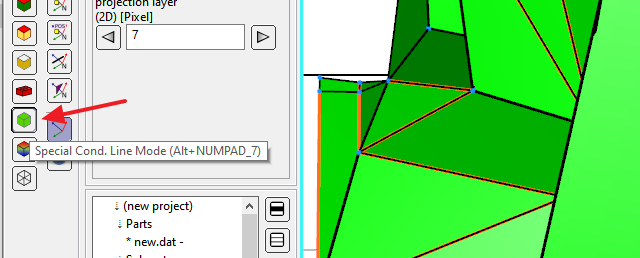

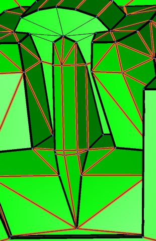

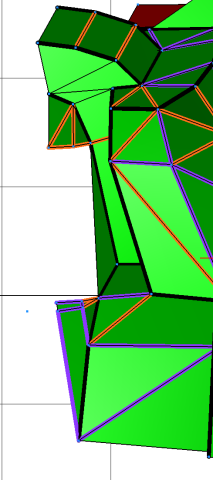

On this image one condline is made visible. The line is placed between the vertices A and B. (One vertex, many vertices).
The conditions for the line is visualized as two other imaginary lines; A-C and A-D.
(Note that this condline have one bad controlpoint, D. To be correct it has to connect to either E or F)
The code for a condline is made of 4 points.
5 <colour> x1 y1 z1 x2 y2 z2 x3 y3 z3 x4 y4 z4
Here is a real one from your part
5 24 3.263 -17.452 -16.378 6.4 -17.495 -16.771 5.979 -19.995 -15.973 7.908 -10.278 -17.106
How do I make it visible?
.png   Image 005.png (Size: 9.45 KB / Downloads: 77)
Activate the Line tool found here, and click on an edge between 2 surfaces.
If there is a condline, it will become visible as this:
Is there a way to find missing condlines?
Activate the Cond Line Mode.  All condlines are now made visible, and orange.
How do I make a new condline manually?
Activate the Create Condline Tool

and then grab all the wanted vertices; A, B, C and D. In that order. One at a time
Remember vertex C and D must be from the 2 surfaces between which you want to create a condline.
.png   Image 009.png (Size: 25.21 KB / Downloads: 76)
Here I'm trying to grab point C
LDPE will not create a condline if the angle between the 2 surfaces are judged as to small.
When you are making condlines the tool sticks to the first, or second vertex. You can release that by pressing Esc and grab a different vertex.
Now, to illustrate what I said in my review.
You need to add condlines in the red squares, and the vertices in the green rings don't match.
And LDPE can't grab a vertex correctly, if the vertices don't match.

I think I got it! I had to merge some vertices for some reason apparently and I also fixed the scaling/postioning of the unalligned primitive.
Subpart
Main part
