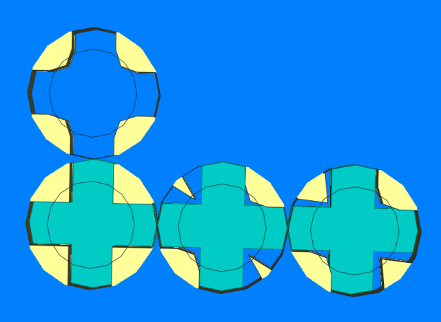

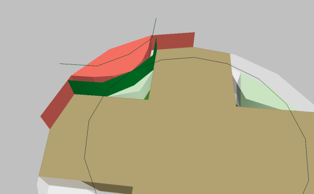

Here an image trying to illustrate the old and new, Javiers and my suggestions.
Tan = the axle.dat primitive
Trans/white = the new primitive axl5hole.dat
Salmon = the new suggested shape from Javier
Green = My suggestion/ Willy's edit
I suggest a change only to the axle hole primitives, and that we should keep the current axle.dat as it is today.

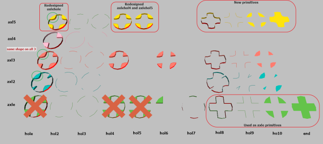

Here is an attempt to summarize what I want to do.
The problem is in the 3 primitives axlehole, axlehol4 and axlehol5. The inner corners should be rounded. Not 90 degrees.
But we need to keep the primitives axlehol8 - axleho10 and axleend, since those are used to make various parts with an axle.
I suggest that the 3 problem axle hole primitves are redesigned using the shape present in the axl2 and axl3 families (in a small green ring in the image). I have created a set of primitives called here axl5hol8 - axl5ho10 and axl5end (yellow, in top right corner). When the hole is given a more correct shape I need the suggested new primitives to close the affected parts.

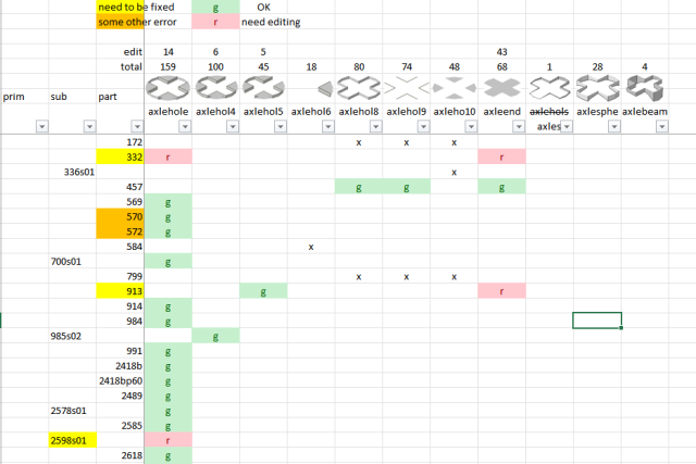

I have made an inventory of all parts using the bad primitives and found that most of them are unaffected if the changes are made in the bad primitives, axlehole, axlehol4 and axlehol5. So, instead of making a complete set of new axl5 primitives I want to redesign the old ones.
(excerpts from the table)
I've found only 25 parts (14 + 6 + 5) that need further editing, mainly corrections using the suggested new(yellow) primitives.
Green in the table are possible to fix without problem. Red need further editing.
The main problem are all parts using the axleend primitives as a bottom to close the axle hole. 43 parts need editing.
All 3 problem primitives are already recycled and currently present at the Part Tracker, without a demand that all affected parts have to be recycled.
I want to edit the 3 problem primitives, allready present at the PT
I want to upload a set of new axl5 primitives.
I still need to further investigate all parts using the axlehol6 primitive.
I have started to edit all the affected parts, some are unoffical and some need to be sent to Admin.
Any objections?

454 files have been investigated.
359 was deemed unnecessary to edit. Editing the primitives will give them a correct look.
95 files was edited, due to design choices made, not using axlehole primitives.
23 files had other issues that has also been corrected/changed.
12 files found with issues unrelated to the axlehole, not fixed.
It probably still exists files affected by the changes in the axlehole primitives, that need editing. Help me find them.

RE: Axle hole primitive on a Bar connection.
#29
Do we have a new overview on the axlehole prims available now and how to use them properly?
Thanks
Reply
#30
(2022-03-26, 9:36)Gerald Lasser Wrote: Do we have a new overview on the axlehole prims available now and how to use them properly?
Well, the primitive reference page needs a major overhaul and is long overdue.
I tried to "sort" the primitives into 2 groups. One group used for axles and the other for axleholes. Inside/Outside. Positive/Negative.
I could make another image, better than the one above.
And maybe we should have renamed or renumbered them? axle-primitives and axlehole-primitives?
Reply
#31
Yes, basically your picture is fine, however there are not all existing right now? correct?
what I found on PT looks like this now to me (Axle2 not with the updated shape)
Reply
#32
Nae...
The entire axlehole family is still in use.
Yellow prims; axlehole, axlehol4, axlehol5, axlehol6 are redesigned, still using the same name.
(This made it possible to correct the design without recycling all affected parts.)
Green prims; axlehol2, axlehol3, axlehol7, axlehol8, axlehol9, axleho10, axleend are not changed.
Should only be used as axle primitives. Not as axleholes. Never inverted.
New prims; axl5hol8 , axl5hol9 , axl5ho10 , axl5end, should be used when axlehole.dat isn't possible to use.
axlehole.dat has included edgelines around the hole. This prevents it from being used inside cylindrical, recessed holes.
axl2hole.dat and axl3hole.dat doesn't. You need to add the edge primitives.
axl4hole.dat has been "autocorrected" since it is using the axlehol6 primitive. (Your image show the old design.)
And yes, updated versions of the entire axl2hole family is now present at the Part Tracker.
Reply

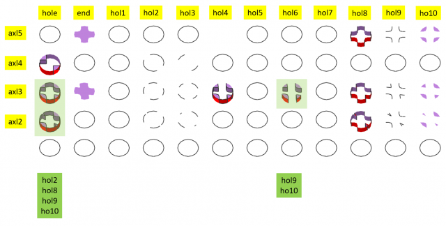

#33
Thanks Magnus makes it clearer!
What I would like to have is a pim of an axlehole pocket.
because currently this is a construction of:
- end (optional)
- hol2 (bottom)
- hol9 (bottom)
- hol8
- hol9 (top)
- hol2 (top)
- ho10 (top)
basically a "hole" minus the bottom "ho10"
may be make use of "hol1" for these?
So only axlehol7 drops out of the pattern

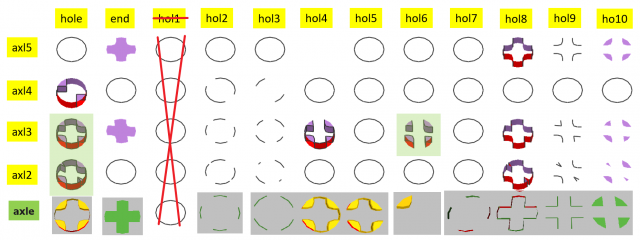

RE: Axle hole primitive unsing chrds
#34
Fitting axleholes into parts is something we should address IMHO.
Mostly they are embedded into either a ndis or a ring primitive. Once a Prim-Substitution is done, gaps appear, as the axleholes themself are mostly just surfaces. So it looks that seperate surfaces to embed an axlehole might seem the better solution to avoid these gaps.
I noticed that
axl2ho10
axl5ho10
are using 1-8chrd prims on their "thicker" parts of the axlehole to better fit to the prims that surrond them.
Additionally, the axl2hole is using a 1-4ering to ocver the thinner side.
As this is not uniform and to make the axleholes interchangable AND avoid gaps, there might be two solutions:
a) Not using chrd and ering in the axle prims
Let the user of the axlehole decide hwo to embed it, so the user can choose if it will be embedded in a ndis/ring and add the necessary 4-4ering themselves, or use triangles/quads
b) using chrd/ering in the axlehole prims
This would imply that an Axlehole is always embedded in a ndis/ring
Embedding it in surfaces would lead to overapping surfaces
I would prefer a).
Nevertheless, I think in the primref we sould give a "best-practice" on how to use those in the end
Reply
#35
I tend to prefer a) too
Reply
