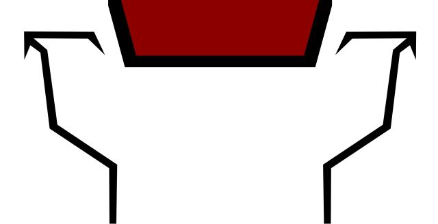

I was trying to create the Round Tile 1 x 1 with Brickheadz eye pattern. See attached.
This is the result:
.png   brickheadzJackSparrow.png (Size: 223.81 KB / Downloads: 594)
Note that the patterns on the bricks and tiles are low-res as I am testing things.
.png   bh-eye.png (Size: 42.61 KB / Downloads: 573)
.dat   98138bh-eye.dat (Size: 471 bytes / Downloads: 13)
.dat   bh-eye.dat (Size: 341 bytes / Downloads: 7)
Jaco van der Molen
lpub.binarybricks.nl
Reply
RE: Texture mapping
#4
(2017-06-28, 12:04)Jaco van der Molen Wrote:
(2017-06-28, 11:10)Philippe Hurbain Wrote: I see no reason why this shouldn't work... Got some screenshots/sample code? See also this round dish with texmap: http://www.ldraw.org/cgi-bin/ptdetail.cg...960p0b.dat
This is the result:
OK, I studied the file you provided and see I am doing things way too difficult and my code and method is not correct.
I'll try to correct.
Edit: done.

RE: Texture mapping
#5
.png   Jack.png (Size: 113.51 KB / Downloads: 585)

I see. I was working way too difficult, still in "sticker" mode, since that is where I started a few days ago.
I was kind of dumb not looking for the part on the PT, but I was so busy creating and playing around with texture mapping I just went on.
Update on the patterns for this Jack Sparrow Brickhead (I do hope the patterns are not on the PT)
I made a hi res (still vector PNG) image of the belt pattern on the 1x3 brick.

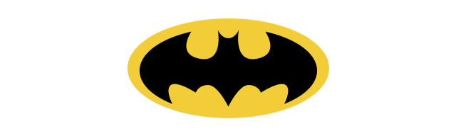

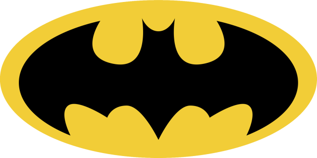

These are fine, Merlijn. Thanks. I'll get right to it.
Done.
The logo on the brick is 4000x1200 pixels.
The belt is 4000x1000.
These should represent the dimensions of the planes on which they must be mapped.
Brick 1x4 is 80x24 LDU, Tile 1x4 80x20 LDU.
The yellow color is #F2CD37 which I got from the color chart reference here:
http://www.ldraw.org/article/547.html
The PNG files are vector so they can be scaled up even further (or down).
Jaco van der Molen
Reply

(2017-06-29, 7:59)Jaco van der Molen Wrote: The logo on the brick is 4000x1200 pixels.
For use with your own custom stickers, this is fine. However, for use in an actual part, it is not a good way to do things. The texture mapping parameters can be adjusted to make the texture map smaller than the geometry it is mapped over. So texture images in official files should always be cropped to not contain any empty space around the edges.
On other thing. The belt texture should be black and transparent. When making a texture, you generally only want to include the part of the printed pattern that is actually printed. In this case, that is just the black lines, since the yellow comes from the underlying part. This guarantees that no matter what exact colors are used for the part, there won't be a mismatch. (It also allows the part to be used in completely different colors from the original, as long as whatever color is chosen contrasts sufficiently with the black to allow the pattern to be visible.)
On the batman logo texture, you would want the bat to be black instead of transparent, even though that section presumably isn't printed on the actual part. That's because that part really is supposed to be black, and not "whatever's underneath".

I don't understand this. If I scale 4000x1200 pixels tot 80x24 LDU it is a perfect fit. Not?
OK, I made the belt with black lines and transparent background. The yellow background was just to show.
Concerning the bat, I think it should indeed be black on yellow and background transparent. You can map it on a 1x4 brick to then use in any color.

You're forcing the app to load a 4000x1200 texture, which then must be loaded into the graphics hardware, even though only a small fraction of that is actually used. So in a typical scenario, this image would require over 24MB of graphics memory in a situation where most of it is wasted space.
Textures often get loaded using a technique called MIP-mapping, which loads multiple progressively smaller versions of the same image. All the MIP-map levels add up to roughly 133% as much memory as the main texture alone would require. 4000 x 1200 x (4 bytes per pixel) x 1.33 = 25,536,000 bytes. Cropped, the image is 1768x879. The same calculation from above yields 8,267,663 bytes, which is just under 1/3 as many. So, since it uses less than 1/3 the memory, but produces identical end results, it's worth it to go that route when creating an official part.

Attached are two files that use the two different methods. batman.ldr uses your original PNG, while batman-crop.ldr uses batman-crop.png (also attached), which is simply a crop of your original PNG. Both should produce identical results when rendered. When I double click on your file from Windows Explorer to load it fresh in LDView, LDView itself uses 70.3MB. When I double click on batman-crop.ldr, LDView uses 52.8MB. With computers and graphics cards having more and more memory as time goes by, that might not seem like much, but it's a 17.5MB difference on one single part. As more parts become textured, it starts to add up. (Note: using the same part multiple times wouldn't multiply the memory, since the texture is only loaded once.)
Attached Files Thumbnail(s)
.ldr   batman.ldr (Size: 182 bytes / Downloads: 9)
.ldr   batman-crop.ldr (Size: 205 bytes / Downloads: 8)

batman-crop.ldr uses more memory than batman.ldr in my LDview (~100MB vs ~85MB). How's that possible then? Or did you mean the vram?

Question: I am going for Iron Man next. How about the pattern on this part:
[Image: 6188122.jpg]
Since this is curved, what would the dimension of the image be?
And how do I map it?

Projection from top. So you need to set the dimension of image to match the base of the brick (40x80ldu), and create the pattern using a photo from top as guide (though since the curvature is rather low here, it won't make much difference)

(2017-06-30, 12:12)Philippe Hurbain Wrote: Projection from top. So you need to set the dimension of image to match the base of the brick (40x80ldu), and create the pattern using a photo from top as guide (though since the curvature is rather low here, it won't make much difference)
OK, something like this:
Can you give me a hint how to project it in LDraw format?
Jaco van der Molen

Same as usual...
.dat   88930im1.dat (Size: 842 bytes / Downloads: 7)
