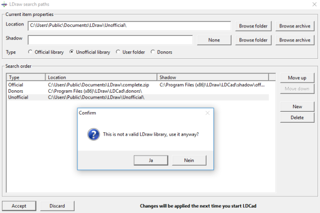

Adding an unofficial library and browsing for:
C:\Users\Public\Documents\LDraw\Unofficial\ (which is my actual unofficial library)
I get the following pop-up:
"This is not a valid LDraw library, use it anyway?"
Which is misleading 'cos it IS a valid library, "unofficial" but valid. This is even more misleading as I obviously don't get such a pop-up when I select the parent:
w.
LEGO ergo sum
Reply
RE: LDCad 1.6 Beta 2a (win+linux)
#10
(2017-04-20, 12:57)Willy Tschager Wrote: Adding an unofficial library and browsing for:
That message should only appear when the chosen location misses the parts and or p subfolders (and also doesn't contain a complete.zip in case of the first start lib browse).
I'll try to change it into something more clear.

(2017-04-20, 17:08)Roland Melkert Wrote: That message should only appear when the chosen location misses the parts and or p subfolders
Hmm ... my "Unofficial" contains only a "Parts" folder. Could that be the reason?
w.
w.
Yes that's the reason, I could change it to not complain if only one of the two folders is present when it concerns a unofficial library. But it might be confusing, personally I think any library should have both even if one is empty as it becomes part of the search path tree.

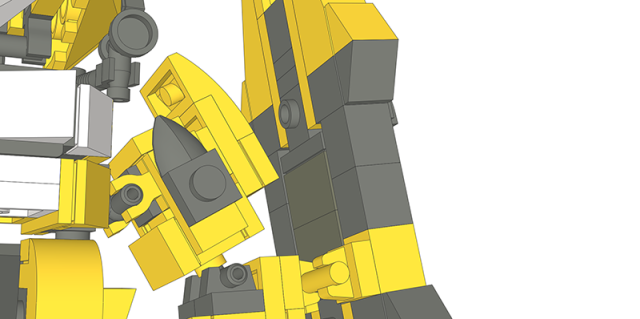

(2017-04-25, 2:52)Daniel LEE Wrote: Make sure that the thickness of the block on the edge of the block is adjustable.
I did consider this but personally found it very ugly when using anything else then the (OpenGL) line width of 1.0. This because it also causes problems with the 'hot' / selection indication (z-fighting).
But I could make it a hidden option (main.cfg only) if you really want to play with it.

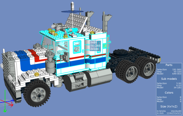

I'd like to see the amount of parts currently selected. For example, if I select all parts of the same type, I'd like to see how many.
Reply

(2017-05-03, 17:27)Merlijn Wissink Wrote: I'd like to see the amount of parts currently selected. For example, if I select all parts of the same type, I'd like to see how many.
+1!

RE: Last bug call LDCad 1.6 Beta 2a
#29
(2017-05-04, 17:47)Merlijn Wissink Wrote:
(2017-05-03, 19:06)Roland Melkert Wrote: I'll try to add it to the statistics panel (right bottom) as it should be a low impact feature.
If that's possible, that would be great!  Smile
How's this:
Reply
#30
That looks perfect!  Big Grin
Reply
