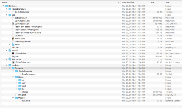

On the LDPE front, I looked inside the application bundle and not much was readily apparent as an executable file besides Unix files that took me straight to Terminal, which then took me to the application itself. Here's a picture of the file directory so you can tell me where it might be.

Quote:On the LDPE front, I looked inside the application bundle and not much was readily apparent as an executable file besides Unix files that took me straight to Command Prompt, which then took me to the application itself. Here's a picture of the file directory so you can tell me where it might be.
Thanks!
It's the one almost in the middle of the screen: MacOS->LDPartEditor (note in the right-hand column it says "Unix Executable"). But when you download LDPE from Nils' site, it comes with a shell script (the .sh file) that will open the executable automatically. To do this, just open Terminal and paste in the command found in the .sh file.

(2024-05-10, 1:38)N. W. Perry Wrote: I've not used WineBottler, but Crossover does something similar (wants to set up different "bottles" for each app I want to run). But I've not found it necessary; you should be able to double-click the .exe file and it will launch Wine and open up for you. How did you download/install Wine, as that might make a difference?
I downloaded the Stable dmg file from this url: https://winebottler.kronenberg.org/downloads and manually installed it. It seemed like the official version. I might be able to find Crossover if it would help you help me figure out what to do.
Where do I find Nil's site for the shell script, or what is the command contained within it? Because that might be my problem, since I only tried clicking on the Unix file itself. This took me to Command Prompt where I was at a loss as to what to do.

Quote:Where do I find Nil's site for the shell script, or what is the command contained within it? Because that might be my problem, since I only tried clicking on the Unix file itself. This took me to Command Prompt where I was at a loss as to what to do.
Thanks!
The download site is here: https://nilsschmidt1337.github.io/ldparteditor/
The command to open the app is simply this:
Code:
/Applications/LDPartEditor.app/Contents/MacOS/LDPartEditor
I have created a self-opening "app" for LDPE using ScriptEditor. The script is this, and I save it as an app called LDPartEditorOpen.app:
Code:
tell application "Terminal"
    do script "/Applications/LDPartEditor.app/Contents/MacOS/LDPartEditor"
end tell
