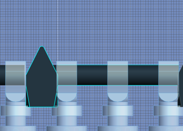

I think there are some wrong dimensions on part 4522. Based on its use in set 10185 (see image), I propose that the head should be an even 12 LDU wide, instead of 12.5. And it should probably be centered on the handle, so it protrudes 8 LDU on either side (right now it's ~8.5 and 7.5).
Does anyone know of any other uses that would support (or refute) these adjustments?

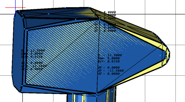

Checking with calipers it is indeed 4,79mm  to 4.85mm translating to 12 LDU
Interestingly the raw data shows also a 12.5 LDU height, meaning even in LEGOs tools this should create a collission :-)
Blue is the one in the library, col16 is the original data

(2024-02-09, 11:04)Gerald Lasser Wrote: Checking with calipers it is indeed 4,79mm  to 4.85mm translating to 12 LDU
Looks like I'm right about needing to lengthen the nose, then? Is that 8 LDU on either side of the handle (and therefore, 24 LDU all the way across)?
Where can one find the raw data, anyway?
