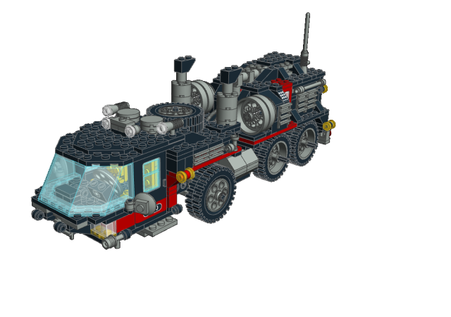

I've been working on building some of the 80s and 90s Model Team sets in MLCad and noticed they are not in the repository here.  I'm planning to post more, including alternate models, as I make them OMR compliant, but I suppose I'll wait for this one to be reviewed first so I know if there's anything I need to fix.
5571 Giant Truck (a.k.a. Black Cat) [primary model]
Download MPD file
Substitutions: 32004b.dat (Wheel Rim 18 x 41 Model Team Type 2) for missing part 32004a.dat
Reply

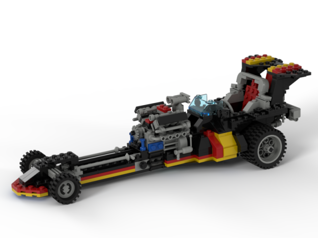

Here are the A and B model of Model Team set 5540. The A-Model doesn't have the stickers yet, B-model doesn't use the stickers.
They're created with MLCad and contain also metacommands for LPub 3D.
They should be OMR compliant, please let me know if they're not.

Believe it or not I don't remember this!
According to the OMR Spec:
https://www.ldraw.org/article/593.html
the file name should be something like:
5540 - Formula I Racer - A Model.mpd
5540 - Formula I Racer - B Model.mpd
Did you run it through MPDCenter or tried https://brickhub.org/ which also gives you some clues?
w.

(2019-07-27, 23:18)Willy Tschager Wrote: Believe it or not I don't remember this!
w.
It'll get fixed when it's added to the OMR. Just remember for the future.
Reply
RE: Model Team
#6
(2019-07-27, 23:27)Orion Pobursky Wrote: It'll get fixed when it's added to the OMR. Just remember for the future.
Fixed the files and uploaded to the OMR.

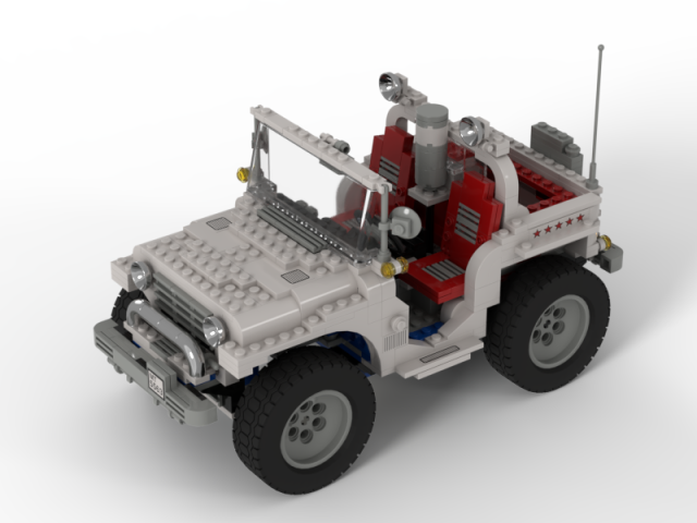

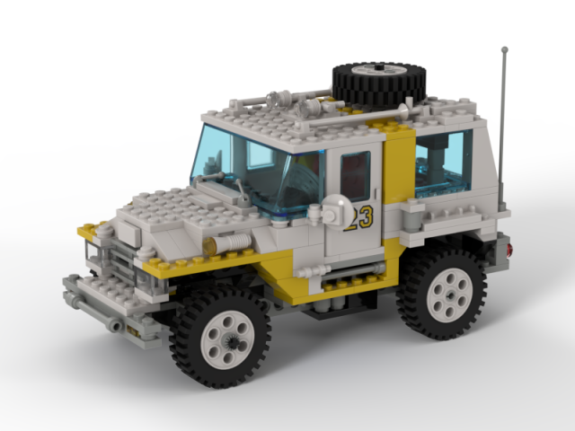

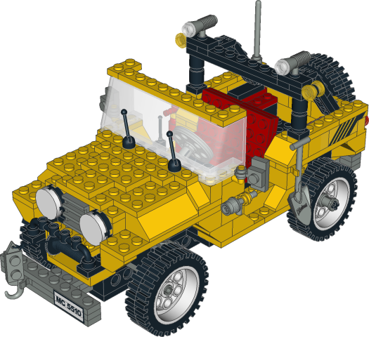

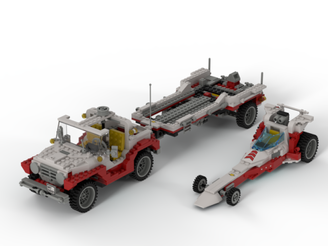

5510 - Off Road 4 x 4
Main model:
.mpd   5510 - Off Road 4 x 4 - Main model.mpd (Size: 225.77 KB / Downloads: 10)
OMR compliant: Yes
Complete: Yes
Errors: None (note: unofficial revisions of 4208 and 4330 are inlined; remove "u" from partnames to use official versions)
Done with LDCad v1.6d
Reply

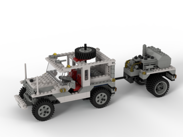

B model:
(variously described as a tow truck or crane)
.mpd   5510 - Off Road 4 x 4 - Tow Truck.mpd (Size: 214.96 KB / Downloads: 6)
OMR compliant: Yes
Complete: Yes
Placement of the front and rear stickers isn't indicated in the instructions, but can be determined from box artwork photos.
Reply

(2019-07-27, 16:28)Rene Frijhoff Wrote: Here are the A and B model of Model Team set 5540. The A-Model doesn't have the stickers yet, B-model doesn't use the stickers.
I'm doing the stickers now for this set. I had to approximate the sizes from the BL image along with clues from the instructions, but most of them turned out slightly too large. (This seems true to life, actually; in photos I've seen of the real model, some stickers do seem to be cut a bit too big to fit.) So I just need to revise the dimensions.
If anyone does know the real measurements, of course, that would be handy!

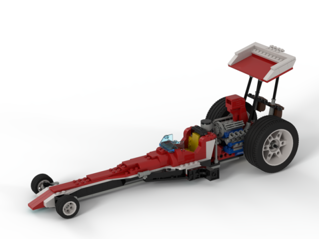

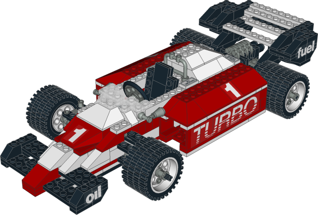

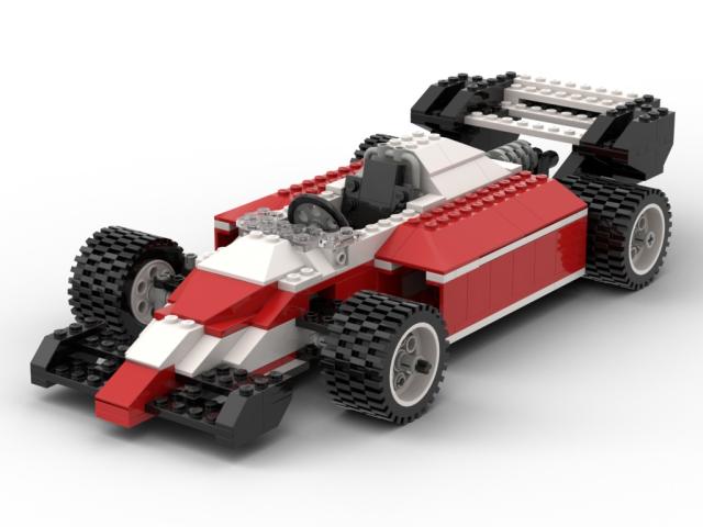

5540 - Formula 1 Racer
Main model:
.mpd   5540 - Formula 1 Racer- Main model.mpd (Size: 205.59 KB / Downloads: 12)
An alternate version including stickers.
There are also two versions of the flexible hoses inlined. Those with filenames ending in "-o" can be used when the engine cowl is removed, giving the hoses a more natural curvature when they are not compressed by the cowl. Just select all the hoses and toggle the MLCad HIDE metas to switch versions.
OMR compliant: Yes
Complete: Yes
Errors: None
Reply

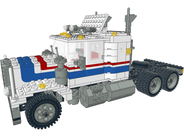

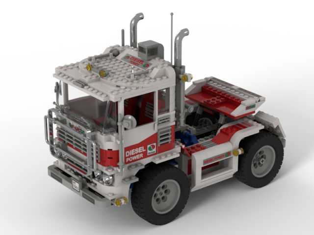

5580 - Highway Rig
#12
.mpd   5580 - Highway Rig.mpd (Size: 37.2 KB / Downloads: 10)
OMR compliant
Missing items: none
Edit 2024-05-13: Corrected the position of vertical axle 3706 avoiding collision with crown gear 3650a, OMR compliant as the sticker 197925a got official
Reply

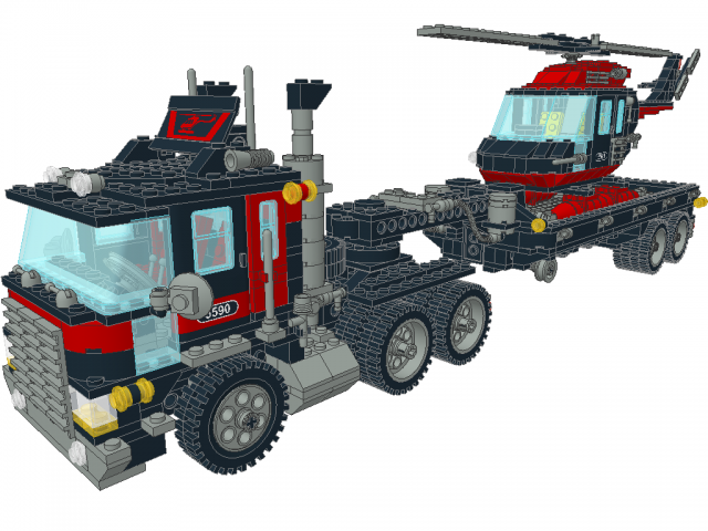

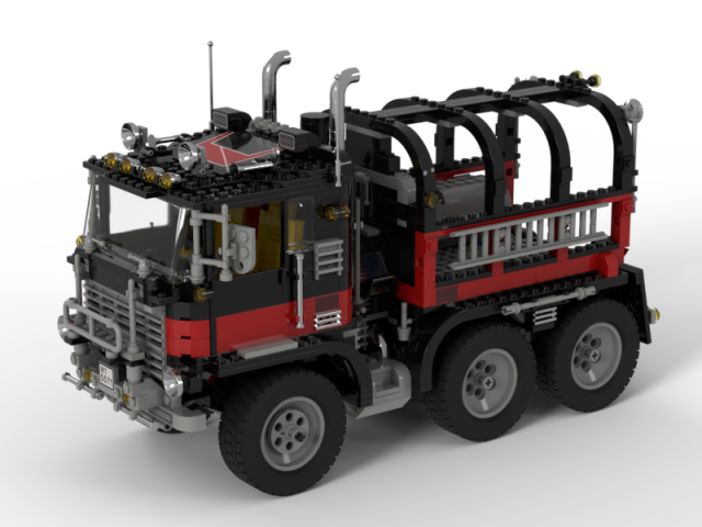

5590 - Whirl and Wheel Super Truck
#13
The first regular set consists of 1000+ pieces!!
.mpd   5590 - Whirl and Wheel Super Truck.mpd (Size: 71.95 KB / Downloads: 8)
OMR compliant
Missing items: none
EDIT 2022-08-06: Updated MPD, corrected moved-to references and got OMR compliant with 2022-04 parts update
Reply

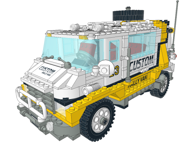

5550 - Custom Rally Van
#14
5550 Custom Rally Van (1991)
.mpd   5550 - Custom Rally Van.mpd (Size: 25.99 KB / Downloads: 7)
Currently not OMR compliant (Unofficial stickers not inlined)
Missing items: none
Reply
RE: Model Team
#15
5590 B Model:
.mpd   5590 - Helicopter Super Transporer - Fire Truck.mpd (Size: 44.83 KB / Downloads: 5)
Note: The name is from Uk catalog
File is OMR compliant and have no items missed
Reply
RE: Model Team
#16
(2022-08-04, 21:24)Javier Orquera Wrote: 5590 B Model:
Dear Javier,
Thanks for creating B-model!!
I've noticed the A-model got OMR compliant by latest parts update (the formed sticker became official) and updated it.
Reply

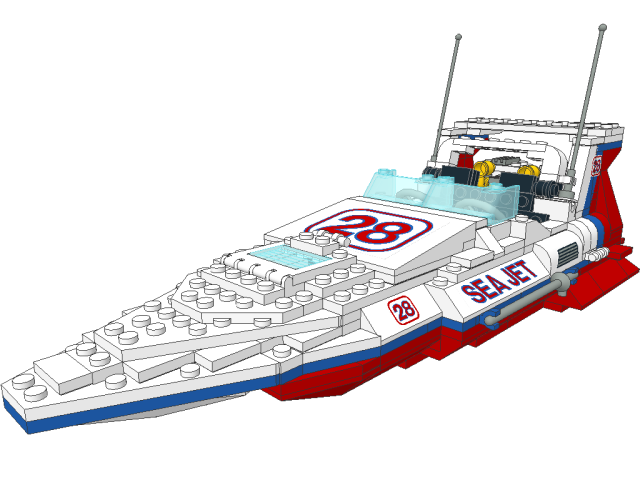

#17
5521 Sea Jet (1993)
.mpd   5521 - Sea Jet.mpd (Size: 20.57 KB / Downloads: 2)
Originally created by Orion, and updated with official stickers
OMR compliant
Missing items: none

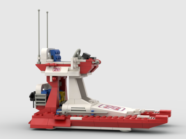

Thanks for the stickers Takeshi! Here is the 5521 B-Model from the instruction book.
5521 - Sea Jet - B (1993)
.ldr   5521 - Sea Jet - B.ldr (Size: 22.49 KB / Downloads: 0)
OMR compliant: yes
Missing items: none
Made in: Studio, LDR export checked in MPD Center
Reply

(2023-08-20, 6:54)legolex76 Wrote: Thanks for the stickers Takeshi! Here is the 5521 B-Model from the instruction book.
OMR compliant: yes
Missing items: none
Actually the stickers are not created by me, I've only updated  the A-model.
Thanks to Damien for stickers and shortcuts.

RE: 5580 - Highway Rig
#24
5580 - Highway Rig - B Model
.mpd   5580 - Highway Rig - Model B.mpd (Size: 34.04 KB / Downloads: 0)
File OMR compliant
Known issue : None
Reply
#25
(2021-12-05, 0:21)Takeshi Takahashi Wrote: Currently not OMR compliant (unofficial sticker not inlined)
Missing items: none
Could be OMRised, sticker is official.
Vertical axle 12 must be lowered to avoid contact with the 24 tooth crown gear.
Thanks for all your model.
Reply
#26
(2024-05-08, 10:05)Marc Giraudet Wrote: Could be OMRised, sticker is official.
Thank you for your review.
I'll update the model.

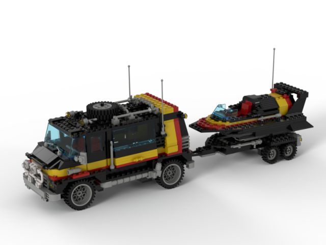

RE: Model Team
#27

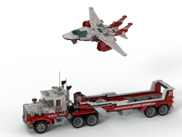

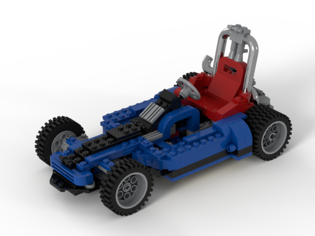

5591 - Mach II Red Bird Rig
.mpd   5591 - Mach II Red Bird Rig.mpd (Size: 74.07 KB / Downloads: 0)
File OMR compliant.
Known issue : Missing string.
Unofficial part embedded
Reply

5591 - Mach II Red Bird Rig - Model B
.mpd   5591 - Mach II Red Bird Rig - Model B.mpd (Size: 54.33 KB / Downloads: 0)
File OMR compliant.
Known issue : None
Reply

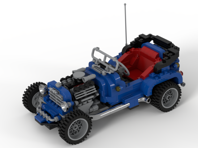

#29

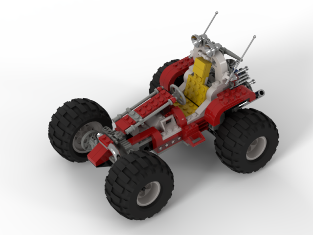

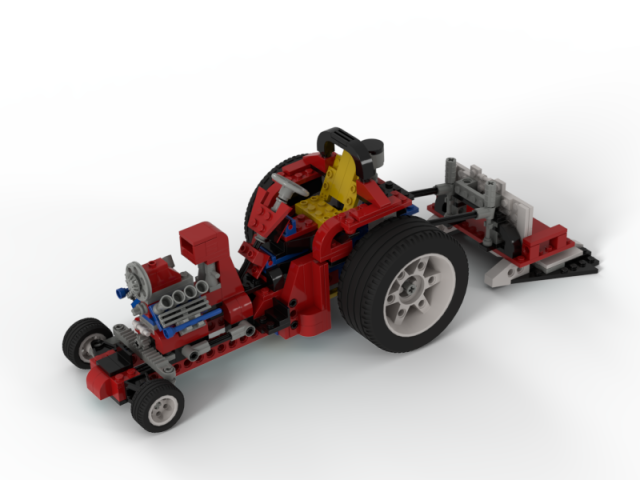

5533 - Red Fury
.mpd   5533 - Red Fury.mpd (Size: 66.85 KB / Downloads: 0)
File OMR compliant.
Known issue : Stickers missing.
V2 : Wheel 2998 rotated 45° to match Technic Bush 3713
Reply

RE: Model Team
#31
very small nitpicking to the Set 5533:
to fit the technic bush onto the Technic Wheel 2998, you have to fit the "toothed" side at 45° (the axle has to be rotated).
That is the second way to get these wheels driven, works like putting these "teeth" of the bush onto a 2xX technic plate.
But that is a very small error, like two unrotated gears with colliding teeth. (how is that handled here and in the OMR?)
Reply
RE: Model Team
#32
(2024-05-11, 20:21)Rene Rechthaler Wrote: But that is a very small error, like two unrotated gears with colliding teeth. (how is that handled here and in the OMR?)
I often don't bother to align gear teeth 😉
Reply
RE: Model Team
#33
(2024-05-12, 12:31)Philippe Hurbain Wrote: I often don't bother to align gear teeth 😉
I always bother to align them, and lots of other stuff besides. Tongue
But that's just me; there is no rule for the OMR that models be error-free or built to any strict technical standard.
Reply
RE: Model Team
#34
(2024-05-11, 20:21)Rene Rechthaler Wrote: very small nitpicking to the Set 5533:
Thanks for the tip about 2998 wheel, I didn't notice that. Both model updated (I rotated wheels). For teeth alignement, I did it for my older models but for some with universal joint or gear boxes it was crazy. My rules now is no rotation for gear. I model with LDCad and render with Studio. Before rendering, I use the collision tool of Studio. Most angle calculation are made with GeoGebra.
Reply

5581 - Magic Flash - B Model
.mpd   5581 - Magic Flash - Model B.mpd (Size: 22.19 KB / Downloads: 0)
File OMR compliant.
Known issue : Sticker missing.
