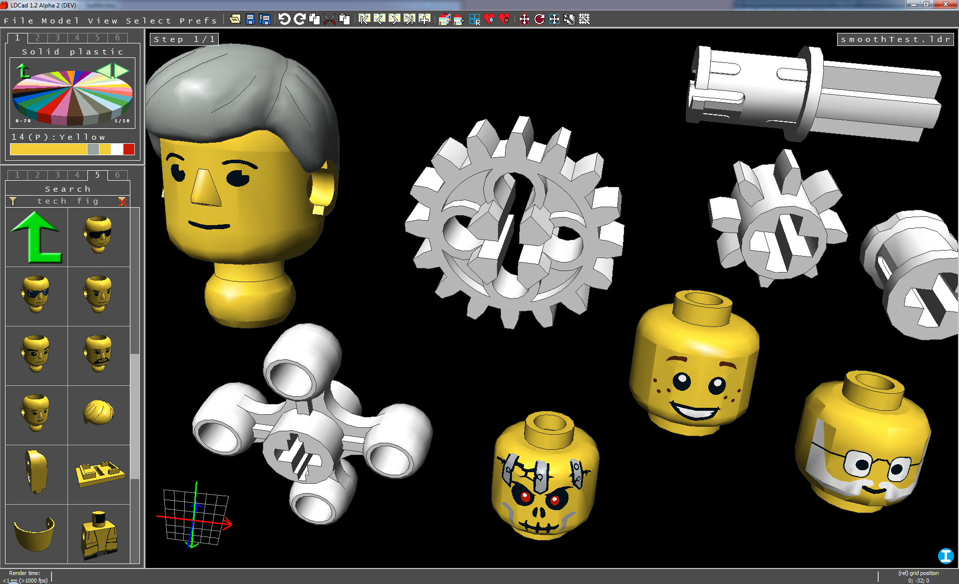

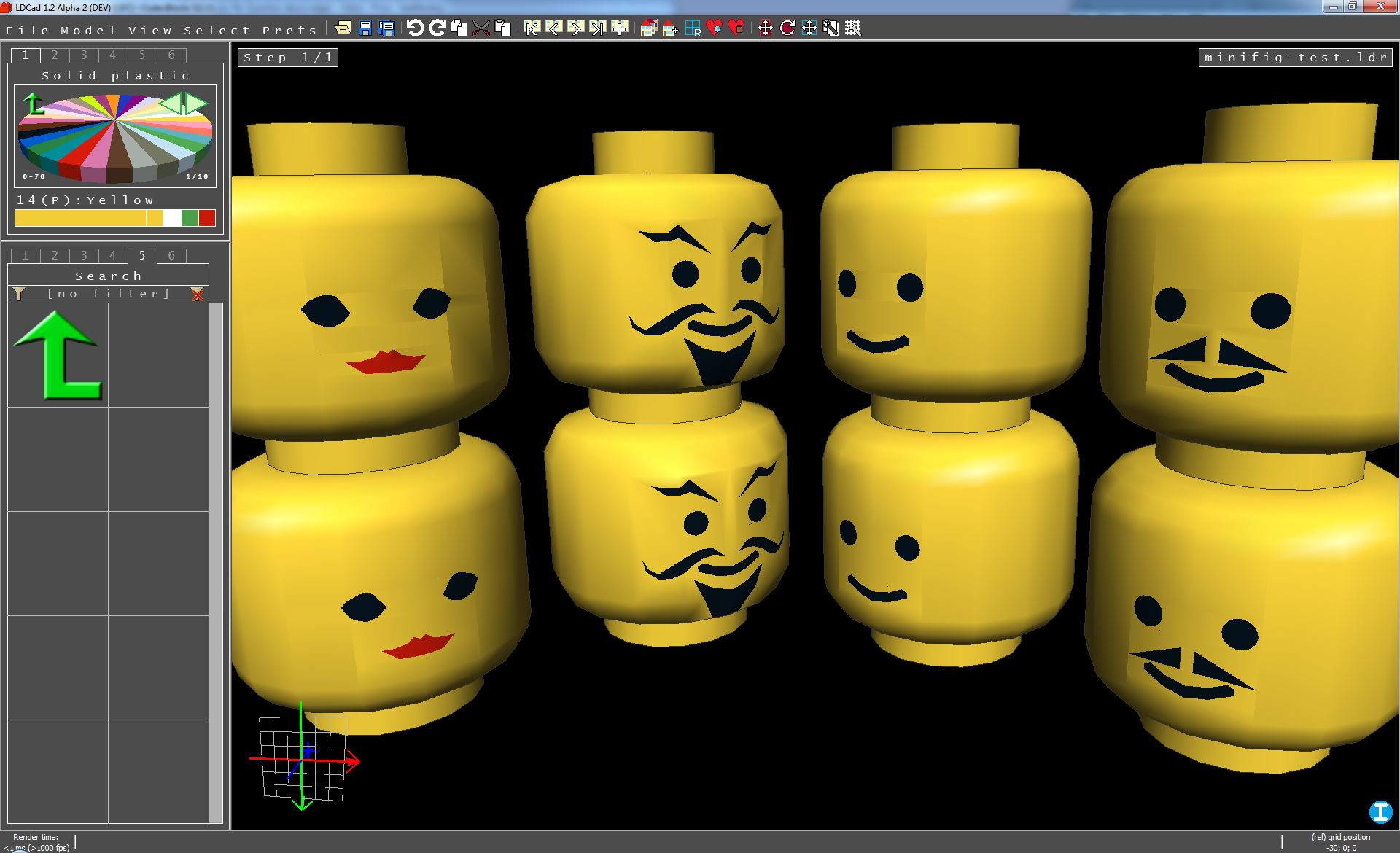

#9
It would be nice to have an universal guide line.
As a result to Philippe's answer above I decided to try my original approach but without using any edge information at all. So by just looking at angles (acos'ed dot products actually) to decide to group stuff or not.
It works remarkably well, so well in fact I'm kinda glad I dropped the edges approach Smile
[Image: smoothTest1a.png]
This is using the (ludicrously wide) angle threshold of 60 degrees, could probably lower that to 30 or so, haven't decided on that.
Downfall is things go 'weird' with high details on a curved surface, like minfig heads which seem to have a crumbled paper thing going on. I'm not complety sure this is the result of the general algorithm or a minor bug on my side.
[Image: smoothTest1b.png]
But in general this approach's results ares very acceptable given the cost. Could probably optimize things to bring it at a loading level only slightly slower then the current LDCad loading times.
If we are serious about helping smoothing by introducing rules on the library, some kind of hint system would be most useful. Like: these following triangles all lay on a curved quad. A bit like the texture projection hints. This would make it possible to generate normals based on a common (cylinder) center instead of the surrounding triangle normals.
Reply

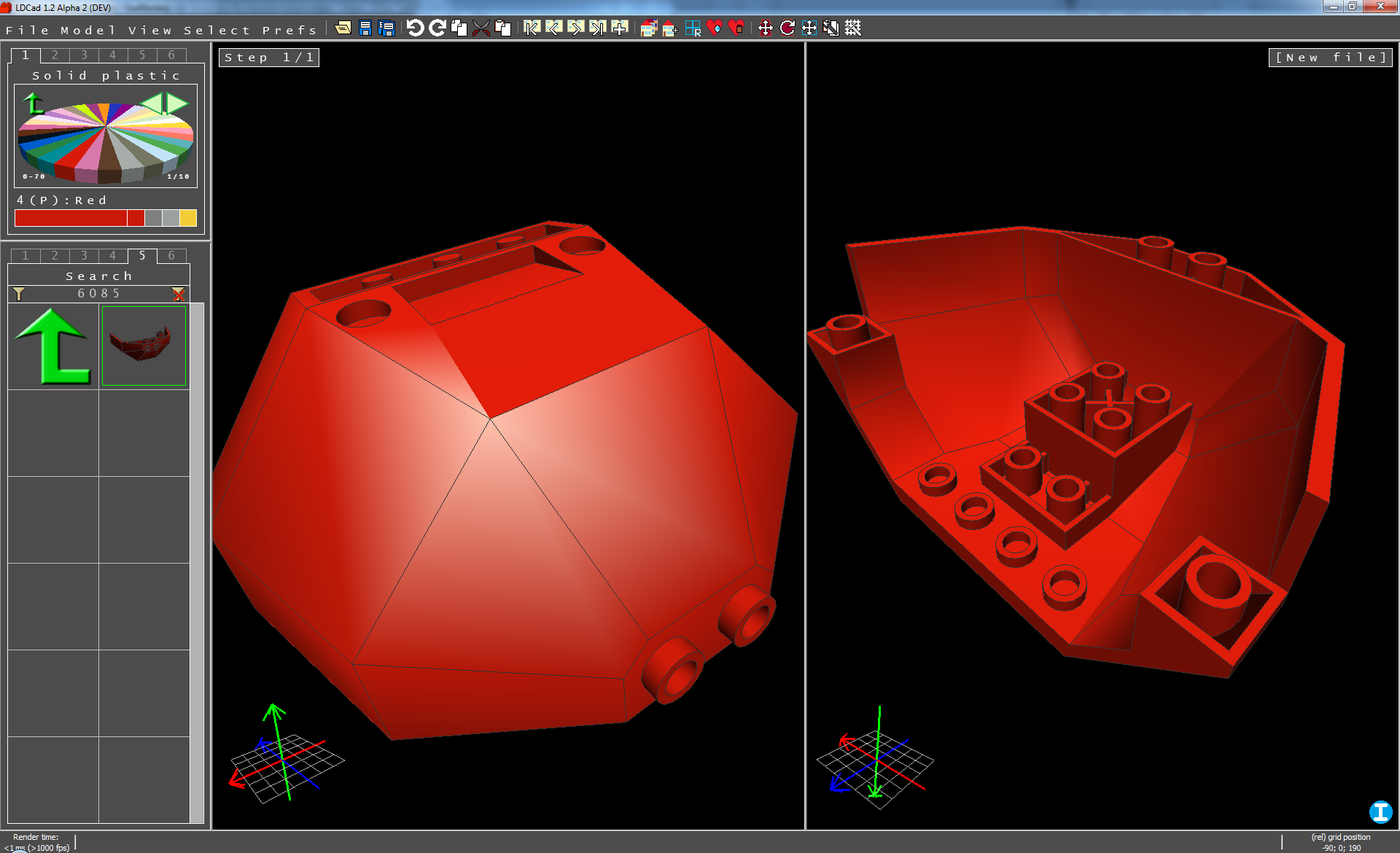

Hi Roland,
I think the artifacts in the minifig-heads pic are induced by bugs and not by the limits of crease-angles, because there appears to be flat-shading errors at very low angles (e.g. nearly smooth sides). But it is also possible that the meshes aren't manifold or contain tiny cracks that throw your code off.
Could you post a screenshot of parts 6085.dat with the crease-angle smoothing? If I understand, it may look weirdly rounded due to the soft angles.
Also, how are you handling BFC? Does your algorithm assume BFC or cope with the case where the winding order of adjacent triangles is opposite (thus inducing opposite normals)?
cheers
Ben

Re: Question about edges
#12
This one?
[Image: smoothTest6085.png]
It looks fine even though it isn't bfc, but because all it's subparts are make it a non issue I think.
At the moment I assume a perfect library, so I handle it like everything is bfc Smile. I figured the angle stay more or less the same (because of the smallest angle result of dot products) and re normalizing will take care of most other problems resulting from non bfc meshes. I realize this isn't optimal but this is just an experimental implementation, so much room for improvement.
Low angle stuff is in deed a problem at the moment (using a whopping 60 degree threshold at the moment), but the nice thing is the edge lines will fix most of that problem (due to they optical illusion/misdirection they supply). Take a look at the slope bricks in the 5580 model for example.
I'm also hoping per pixel lighting will fix things even more by removing, the some times, weirdly shaped hot spots.
Reply

On the t-junctions and minifig head things:
Last night I've tried a very quick and dirty implementation of using a meta for smoothing direction of curved planes with details.
Although it looks somewhat better, it's still not 'perfect', mostly due to the t-junctions indeed.
[Image: smoothMetaTest.png]
edit: the top ones are useing def smoothing on standard library parts, the lower ones use a modified .dat.
But even with no t-junctions I'm expecting a somewhat 'flattens/dented' facial area due to the distance of the detail vertices in regards to the 'cylinder' radius. When all t-junctions are resolved (or at least for the face geo) you could correct that by scaling all vertices using the same guidance cylinder. I would expect a (nearly) perfect minifig head in pretty much all situations after that.
But it will need a new meta, my quick implementation uses this, but it could be much much more powerful:

I forgot to mention, only the lower ones use the meta.
Normals in the LDraw format would be the best way to go, but like said before editing all existing parts is going to take ages, just look at the timespan BFC is taking.
For new parts the combination of >60 deg and matching type 2 lines (I think type 5 don't matter for smoothing) would be a very good and reasonable requirement.
Don't get me wrong I'm thankful to the part editors we getting all these parts in whatever form.
