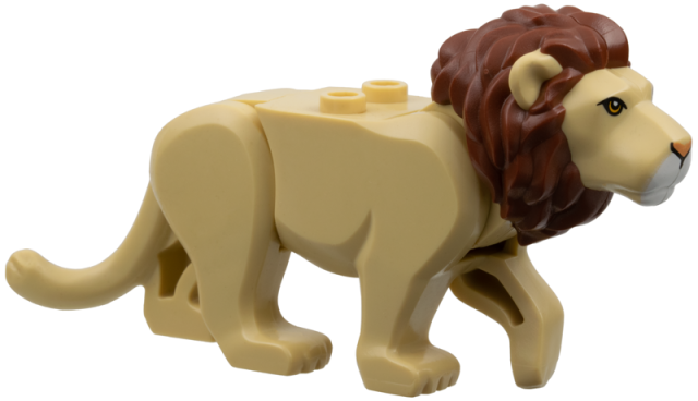

Hello everyone,
Would it be possible to add this item, please?
[url=https://www.bricklink.com/v2/catalog/catalogitem.page?P=bb0787c04pb02#T=S&C=2&O={"color":2,"iconly":0}]https://www.bricklink.com/v2/catalog/catalogitem.page?P=bb0787c04pb02#T=S&C=2&O={"color":2,"iconly":0}[/url]
Ref: bb0787c04pb02
Cat, Large (Lion) with moulded reddish-brown mane and printed bright light orange eyes, nougat-coloured nose and white muzzle pattern
Thank you Smile

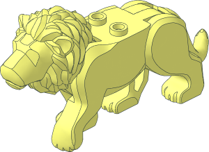

The lion is up. No print yet. Any good images of the face?
[Image: 77589.png?v=1786656165]
https://library.ldraw.org/parts/53852
