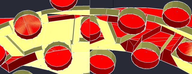

I am working on 7664, but I got questions:
I tried to copy the bottom from 7344, or are narrower gaps (touching the stud) better? Should the gaps be the same as on the other curved parts?
Reply
RE: 2026 - New Parts -> Raw Meshes -> Discussion
#19
(2026-03-05, 20:37)Rene Rechthaler Wrote: I am working on 7664, but I got questions:
Stud cavities tend to be bigger in the raw mesh and often need to be shrunk.
