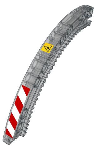

Hello everyone!
After completing set 42055-A some time ago, I started working on set 42055-B and
noticed that I could only modify part 24121d02.dat in this model.
I then tried to create part 24121d03.dat, but failed when mirroring
sticker 6155286wc01.dat.
.dat   24121d03.dat (Size: 602 bytes / Downloads: 3)
Would anyone be willing and able to complete this part and submit it to Parts Pracker?
Best regards, Alfred

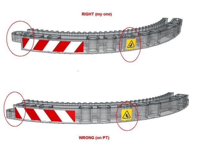

Hello Peter!
I was able to solve it with your help!
Would you like to submit the attached file ‘24121d03.dat’ to the Parts Pracker under YOUR name after possibly correcting the header?
(I'm not a parts author, after all.)
You wrote: "Same for when changing the 24121d01.dat for the other side."
That's not nessesary, part 24121d02.dat can here be used!
Thanks Alfred

Hello Peter!
The part you uploaded file on the Part Tracker is wrong.
Please use my attached file from this morning.
It is right!
Reply

OK thanks I changed it.
