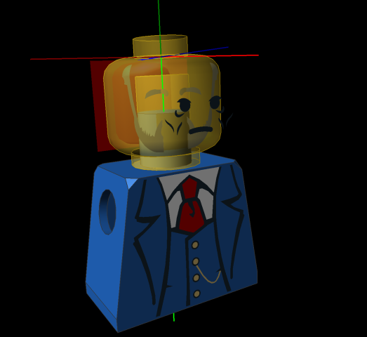

I edited the file a bit to see how its structured:
The red quad visualises the input parameters of the texmap command.
I like how layers are implemented in this example. In this examples the coordinates of the pattern match the coordinates of the part, how would you reuse a pattern on a different part. Should the texmap command include transformation parameters for the pattern?
This is the modified file:
.ldr   ldrTexTest.ldr (Size: 9.99 KB / Downloads: 1)
Reply

#60
(2026-02-28, 16:56)Hageta Wrote: I like how layers are implemented in this example. In this examples the coordinates of the pattern match the coordinates of the part, how would you reuse a pattern on a different part. Should the texmap command include transformation parameters for the pattern?
I got the 1/2 face pattern from Chris, only removed the yellow filling.
Fun thing about 2d projection is you don't have to worry about overlap so if you need some black text on a white background you would only need to add a white quad and the text itself for it to work as a texture.
As for reusing the pattern there are no real limitations. Although there are some things that will make it harder to implement.
Like using color16 inside the texture pattern, a renderer would need a special shader or prepare a separate texture for each color usage.
(2026-02-28, 16:56)N. W. Perry Wrote: As a first test result I'd say it's already quite promising. I'd be curious to see the difference from a cylindrical projection (I assume the result is no different than the current method).
On the question of resolution, as far as I can tell this comes out no worse than the maximum available in LDCad, which I think is as it should be.
I since replaced the hardcoded 1280x1280 with a resolution of 50 times the source's ldu width/height which in this case end up as 1200x950
Reply
