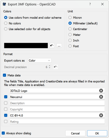

You will now see this dialog:
Choose "Use colors from model and color scheme". Under Unit choose the one you used, if you used LDraw Units leave it on Millimeter. The Metadata is optional and the following field will be read by 3DToLD:
- Title will be used for the "Descriptive Part Name"
- Designer will be used for the Author
- License will be used for "Part License"
Import into 3DToLD
Now open 3DToLD. If you designed your model in LDraw units change the unit from Auto to LDraw. If your model is designed with -Y as the up axis(LDraw) uncheck "Use LDraw Axis". Doing both of these also removes any transformative processing on the model. Now press the "Load File" button and select your 3mf file. The metadata fields should be populated with the ones you choose in the previous step. The colours are initially direct colours, if you used my LDraw Colour Library you can convert them easily to proper LDraw colours. For that click on "Convert direct/html colours to LDraw colours". Then select the colour categories from wich you used colours and click ok. Your model should now only have LDraw colours. Colours are mapped by their rgb values if two colours have the same values the first in the list is used. Optionally you can also generate outlines(no conditional lines). You can now select your output file and convert/save the model.
