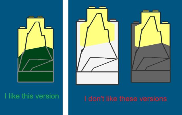

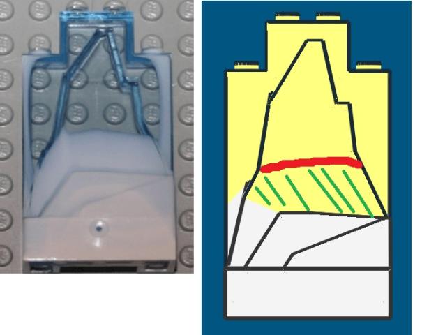

RE: 47847 dual mold
#2
Overall approach looks good IMO.
Though I'd like the lower colour extent a bit further up (green lined area in image):
EDIT:
I think splitting the edge lines/conds is a good idea. Lines take their colour from the base colour of their file; so if s01 is dark grey, s02 trans-orange it might loook odd (trans-orange area getting solid colour edges).

RE: 47847 dual mold
#3
Because the top is sometimes transparent, should s01 (bottom) get a closed shell? or an s03 as internal border?
as of now, you could look from the transparent section into the solid section...
(in the partial transparent variants, looks like there are only transparent tops)
I agree with Chris to have the split a the front higher. (just a full segment, no dithering needed)
the edgelines also should be split.
Reply

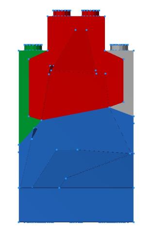

RE: 47847 dual mold
#5
Can something like this go?
However, I believe that the "flames" along the vertical walls are too high a detail. In Bricklink for the white version (p01) they had indicated 3 different versions, but now they are in the process of unification because the colored "flames" are not controllable in the mold phase and are highly irregular.

RE: 47847 dual mold
#6
I would say keep the new mid section and the old sides.
p02 looks different than the other 2. Was that intentional?
I think it's best to keep all colour combinations equal. As the Bricklink page states, this is molded highly random (intentionally so perhaps even). Most of the official Lego renders have an identical pattern too (except 4260510 but 4508430 has the same as the others and the same combo).
To me that feels like it's implying a different mold, which it isn't.
Reply

RE: 47847 dual mold
#8
Chris, Magnus,
I didn't understand what I have to do.
Are the four subparts fine, maybe changing the geometry a bit to make it more irregular, or is there another method/division to do?
I would be ready with a geometry of the part cleaner than the previous one.
I have to adapt the shortcuts with the stickers and then I could send it.
But I would like to make a unique send even with the patterned versions.
Reply

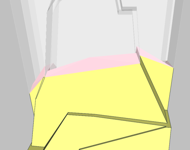

RE: 47847 dual mold
#10
Since the bottom is always using a solid colour, you need to close that mesh. May be better to have that surface in a new, separate subfile.
But you can also use that surface, to create an inner shape, inside the transparent half.
