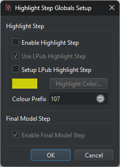

Beginning with LPub3D version 2.4.10, the fade previous steps and highlight current step colour ID 3-digit prefix will be user configurable.
Also, to circumvent the current conflict with 11019 for Trans_Tan, the default fade colour prefix will change to from 100 to 108 and the highlight prefix from 110 to 107.
Users will be able to set their desired prefix in the Globals Setup:
[Image: colour-prefix-gui.png]
...or using the meta command
Code:
0 !LPUB FADE_STEPS COLOR_PREFIX 999
and
Code:
0 !LPUB HIGHLIGHT_STEP COLOR_PREFIX 998

Very well. I can also add that this configurable behaviour is passed to the LPub3D renderer distributions of LDView (-HighlightColorPrefix=999) and LDGLite (-laP999) when the highlight current step is enabled.
Cheers,
