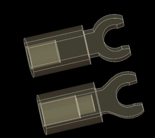

The 11090 in BI has a longer interior bar hole than the current 11090 part on the tracker and there does seem to be a newer version of the part as mentioned in this reddit post to confirm there needs to be a variant made.

There is something indeed... Here is a comparison of the various mesh revisions used in building instructions (placed in sequence a..h). The weirdest is the shallower hole in revision f...??

But we need a version this that small pinhole, since it is a usable connection point.
RB:
Mold version11090 has a hole large enough to fit the pin on accessory parts (eg. plume/flame/feather part 64647). The hole in the later version 44873 is too small.

The hole is large enough but I’m not sure it’s an intended connection (proof being it’s not in the other moulds).

So far it looks like Some time between July - September 2020 was when some type of variant of B - D was first used (can't tell which of those ones it is) Since before that point none of the 11090 parts in the instructions have the circular hole below the claw. I have only checked the black colour though which is the most common I guess its possible it was used earlier in other colours.

Part 23443 is up to revision G in BI, but there isn't any difference in hole depth vs the one on the tracker. The only real differences are that the side pin hole (or whatever it is) is no longer there and the groove is in a different place.
I've attached the latest version of the part from BI.

concerning BI Data of 11090, there are:
61 Sets with revision "B"
37 Sets with revision "E"
1044 Sets with revision "H"
