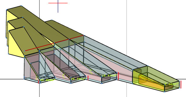

Anyone have any Modulex parts?
I'm working on a set of parts made by Chris Dee and Tore Eriksson.
The zip-file contained the slopes, but are they correct?
In this image from the marketing documents they seem to be of the same height. Both the front ends and the backsides are all the same height.
.png   modslope.png (Size: 105.42 KB / Downloads: 475)
But if I look at the parts made for ldraw they are of different height. And there is not enough space inside the 45 deg slope for a stud.
The angle of the different slopes seem to be correct; 9, 18, 27 and 45 degrees

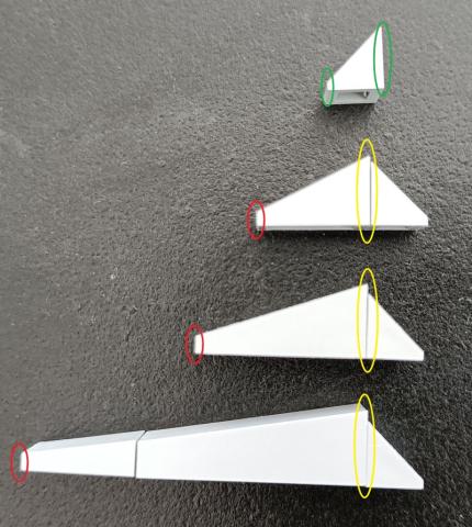

#2
I've got some Modulex parts. The height of the 45 degree slope is less than the height of the other slopes. Refer to this picture:
[Image: 800x894.jpg]

#3
what size are the front lips? looks like only the 45° has a thin one...
how are the back heights compared to the modulex bricks?
can they be stacked/aligned? (like in the LDPE pic)
two identical antiparallel to a block results in what height?

#4
(2025-06-07, 22:57)David Manley Wrote: I've got some Modulex parts. The height of the 45 degree slope is less than the height of the other slopes. Refer to this picture:
Could you please measure this?
Are all 3 red fronts the same height?  How many mm?
Are all 3 yellow backs the same height?  How many mm?
What is the height of the 2 green?
Is there some kind of cutout inside the 45 deg slope, like on the cheese slope 54200?

#5
(2025-06-08, 7:08)Magnus Forsberg Wrote: Could you please measure this?
I don't have a micrometer, so the measurements will be a bit inaccurate. If you would like, I can snail mail you the parts if you can measure them more accurately. You won't have to return the parts to me. PM me if you want to do that. Otherwise I'll provide my less-than-accurate measurements.

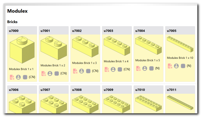

How do I number the Modulex parts?
In the zip a standard brick is called brk0101.dat. I think the rescaled parts can't use the same number. It would brake any model made of those files.
A simple change would be to extend it to be brick0101.dat. The numbers tell the size. A 2x4 brick would be brick0204.dat.
A window would be window0502.dat
Or,
should it be a number series, like the Mursten bricks, u8000-u8999?
s = unknown sticker
t = third party number
u = unknown partnumber
Reply

(2025-06-30, 22:04)Magnus Forsberg Wrote: How do I number the Modulex parts?
Or,
s = unknown sticker
imho u******
Reply
RE: Modulex parts
#12
Use u7NNN
Reply

All the parts from the original zip-file is now rescaled, reworked and uploaded to the Part Tracker
I made a new summary page here, mirroring the original reference home page made by Chris Dee.
Thank you to David Manley, here at the forum, and Godtfred at SweBricks for helping with the measurements.
Now we need some colour codes.
