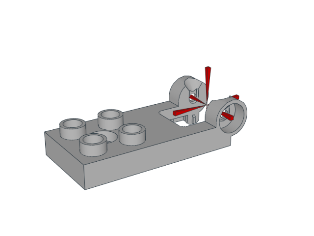

Official part 13358 Duplo Brick  2 x  2 Hinge Base
Unofficial part 13355 Duplo Plate  2 x  2 with Hinge Extended on Side
Unofficial part 25548 Duplo Plate  4 x  4 with Hinge Extended on Side
These parts have both a hinge and a rotational snap. Part 13358 has its origin at the top of the snapping hole, i.e. not at the center of the hinge.
Similarly, a large number of hinges have their origin at the centre of the topmost stud group and not at the hinge. E.g. 92582, 3640, 60471, 44568, 3597, and 30383. These are not following the current requirement of having the point of origin at the centre of the hinge.
Understandably, an origin at a hinge makes placement and rotation around that hinge easier. However, the three parts under scrutiny also have an another rotational axis. The question is now; which rotational axis is primary and which secondary for these three parts? The build order is AFAIK exclusively so that the rotational snap comes first (even if not used) and only then are parts added to the hinge.
What happens in the editor if hinge counterparts have different origin? Can the second part with origin at the hinge still be placed nicely? What about placing the first part if the origin is offset on the side at a different elevation than the studs/antistuds?

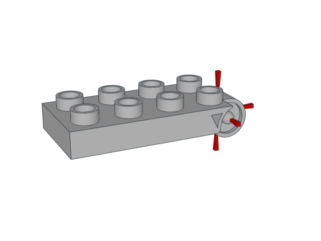

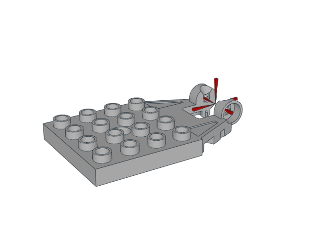

Good point. I'd like to see the origin here:
13355
25548
16686

I agree on 15450.
13358 is IMO wrong. Should have had the origin at base. But let's leave it. At least it's in the rotation center.
13355 and 25548 is correct. Both are designed to swivel around the pin on 92005. Right?
One basic rule is applicable. No studs = origin at bottom. Studs = origin on top stud level.

yes, I also think 13355 and 25548 are correct, because they are mostly "static", and if not, they rotate around the snap pin.
But all of them could need a !Help with the position of the hinge.
Should 13355 and 25548 get subparted more to include the difference to 65084 and 65085 (the small red dots)?
