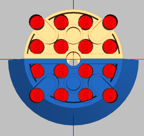

Hi all,
57792 Cylinder  6 x  3 x 10 Half with Taper and Four Pin Holes
needs a small fix on its bottom: it collides with studs (external, flat side; not with the special notches).  The problem has been noticed when trying to build set 7990-1 in Studio.
I don’t know how the real part looks exactly but there’s a picture on Rebrickable that would indicate the shape is correct (that is, there’s no notches for the studs), so the problem would be the radius of the base or the thickness of the wall there.
Anyway, thanks to anyone who would tackle that  Smile

(8 hours ago)Sylvain Sauvage Wrote: Hi all,
seems that the wall is too thick
https://i.ebayimg.com/images/g/JgUAAOSwC...-l1600.jpg
BI part is also sporting a thinner wall.
subfile s01 needs a touch up

Yes,
It should have the same bottom design as 6259, Cylinder  2 x  4 x  4

I have it open, I'll fix it
DONE:
https://library.ldraw.org/parts/45944
Amazing that this was 14 years in the wild and it got unnoticed so far

Woohoo, that was fast.
Thanks Gerald  Smile
Now, to have it included in Studio, with corrected collisions for the main file….
