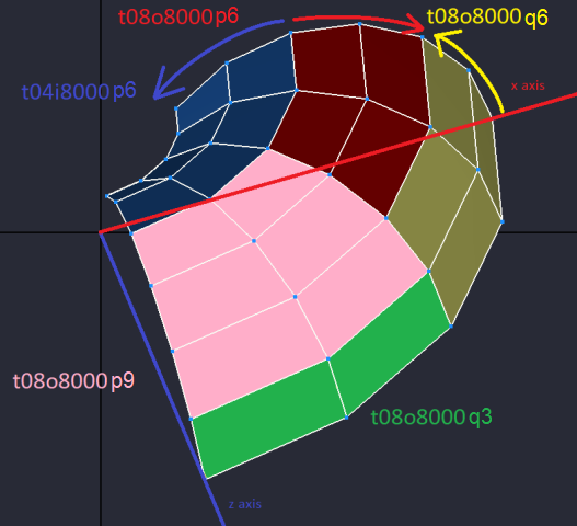

RE: partial torus prims
#3
something like this? (screenshot from LDPE edited with paint)
the addition itself:
t08o800 like the existing syntax
the +/- indicates from where to start
the number states how far to go (+100 would be the same as a -100, a full quarter, no suffix needed then)
usage:
could be useful for chamfers or partially prints
if a torus gets cut somewhere
-> could still apply to prim subst
Reply

edited the upper picture to fit the p+q suffix
p starts from the center line outwards
q starts from the outermost/innermost and goes inwards
last digit is the number of hi-res segments
(hexadecimal to fit it into 1 digit, its - 8 - 9 - a (10) - b (11) - c (12) would be a full quarter -> no suffix needed)
the normal res ones are 3 (1/16) - 6 (1/8) - 9 (3/16)
"special" ones on hi-res are 4 (1/12=30°) and 8 (1/6=60°)
idk how the condlines should be (tangential or continuous)

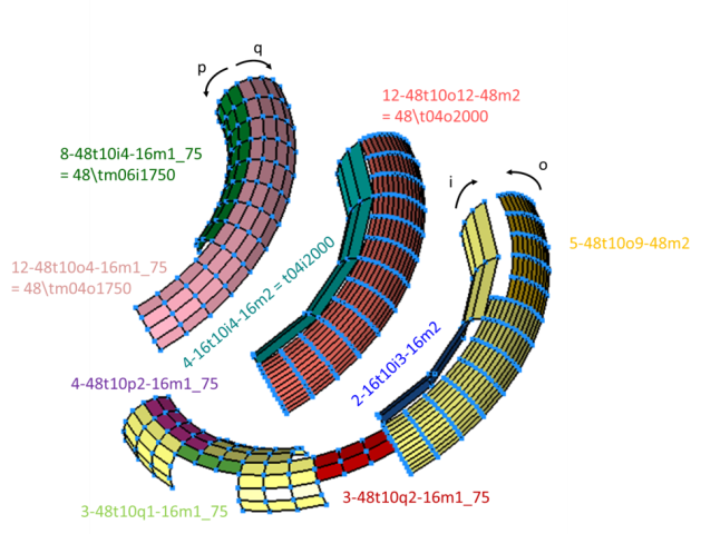

#11
My suggestion was slightly different. Here's a picture:
Reply
#13
I agree that one could use more characters for clarity.
However, if one always copies from the primref, it doesn't matter what is being copied. A systematic naming scheme helps interpret the line once written (reviewing, editing) and helps people generate the right filename without looking at the primref.
The existing tori naming scheme is vastly different from how other prims are named, and thus I suggest improving it.
We have two degrees of freedom here. One for the starting point of the prim, and the other for which direction it continues.
In the context of tori, CW and CCW have just as little meaning for me as p and q have for you. I visualize the major rotation axis on the left and a half circle on the right such that it opens downward. Then 'inner' is the vertex closest to the major rotation axis and 'outer' is the vertex furthest away. For these two starting positions, it doesn't matter which direction the shape continues because it is symmetric in each case. That leaves one starting position, perpendicular to the other two. For convenience, I choose the vertex at the top of my half circle. From this position, one can continue either inwards or outwards. If I write the small letters p and q and put a small arrow at the end of those characters, I immediately see that p is the one going inwards and q outwards. You may have similar visualizations or memory rules for CW and CCW, or plus and minus. The thing is that someone else will likely have a different memory rule which clashes with yours.
We can thus choose from:
inner / small
perpendicular / mid
outer / large
and:
inwards / CCW or CW / plus or minus / p
outwards / CW or CCW / minus or plus / q
For the description, we would definitely choose "inner", "perpendicular inwards", "perpendicular outwards", and "outer", but can we agree on the file naming?
Reply

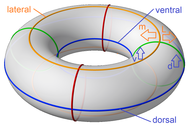

#14
I would avoid using "inside" and "outside" again, these are already used for the full quarters...
I didnt find any mathematical terms for the main lines of a torus:
https://en.wikipedia.org/wiki/Torus#/med..._torus.png
so I looked for other location terms and found them in the anatomy:
- ventral (belly sided) could be the innermost ring
- dorsal (back sided) could be the outermost ring
- lateral (side) could be the side ring
- medial (center) means to the center
>indexes from inside to outside: v as the innermost, then m medial, l for lateral and d as outermost
>the number as before...
edited the wikipedia pic:
Reply
#15
Medial (toward the centre) and lateral (toward the side/edge/outside) are very good suggestions.
However, I'd prefer orbit nomenclature; periaptic (inscribing circle) and and apoaptic (circumscribing circle) for the other two.
Reply
