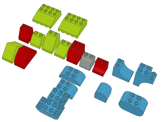

The overview shows certified straight slopes in lime, certified curved slopes in dark azure, unofficial parts in red, and the one certified curved slope in light grey.
