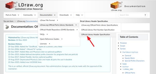

Hej Nathanael, and welcome.
The rules for the header are here:
The best tools for making a correct header are DatHeader and LDPartEditor.
https://www.ldraw.org/downloads-2/third-...tware.html
Maybe you could upload you file here in the forum, so that we can see what you have?
