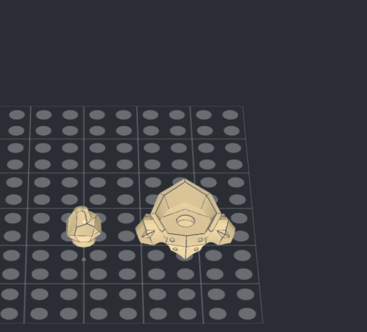

#6
(2024-02-03, 23:29)Orion Pobursky Wrote: I dredged this out of my archive. I'm not sure how well or if it works.
works with OBJ2DAT
thanks
