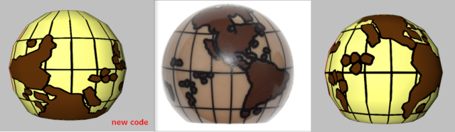

#4
(2024-01-15, 21:17)Toby Nelson Wrote: I see the image appears upside down in LDView. I wonder if that could be a bug in LDView?
This is what I see:
Your code is placing the image upside down
Reply

RE: Issue with hemisphere part with textures
#6
(2024-01-15, 22:33)Travis Cobbs Wrote: I believe that you are correct regarding LDView displaying cylindrical textures upside down. Can you confirm that LDCad displays them the other way around?
However, regarding the part being wrong to use SPHERICIAL, I think that you are wrong about that. The texture is definitely not designed to be used as a Mercator projection. Switching to CYLINDRICAL squishes everything vertically. And while I don't exactly understand why, the lines of latitude are correct with SPHERICAL projection in this part. (Just look at it directly from the side with the original SPHERICAL projection.) While using CYLINDRICAL with an appropriate texture would probably make more sense, the existing texture is definitely not right for that.
Your proposed CYLINDRICAL looks like this (after me flipping things in LDView's code):
.png   61287p01.png (Size: 22.55 KB / Downloads: 130)
The original SPHERICAL looks like this:
.png   61287p01-spherical.png (Size: 22.88 KB / Downloads: 130)
Both images were taken with LDView's FOV set to 0.1.
Notice that all three visible lines of latitude are horizontal on both images. Notice also that the spherical one has more correct aspect ratio of the map. (The cylindrical one has the continents squished vertically.)
Reply
#7
Actually, I think that using CYLINDRICAL is good, it's just that you didn't have it extend far enough. I tweaked the parameters to be this:
(10 LDU added to top and bottom.) That results in the following, which is probably most correct:
.png   61287p01-cyl2.png (Size: 23.13 KB / Downloads: 126)
Note that the lack of texturing on the top cone is due to a limitation in the way the mapping is being applied. It doesn't like the cone at the top (or more specifically it doesn't like having triangles that contain a point that is on the cylindrical axis). I don't think that there is anything I can do to fix that. The spherical mapping has different issues up there.

In short it is possible to do a full globe mapping but the mesh must be formatted to help it along, meaning it must have vertices at the poles and the texture meta must be oriented to match it.
Thanks, I will investigate further. At first glance it seems that no-one liked the spec so they have ignored it in favour of something else.
Reply
#20
(2024-01-16, 22:01)Travis Cobbs Wrote: I'm not sure if you are referring to cylindrical or spherical mapping here. If the former, the UV coordinates are essentially undefined anywhere on the axis of the cylinder. (I think they have a valid V value, but their U value is effectively "all of the above".) If the latter, then I think the same thing happens at the north and south poles. When texture UV mapping is performed in advance, the U value can be calculated based on the U values of the other two vertices in the triangle that touches the pole. But for projected textures, I don't think this is possible.
I was thinking of the cylindrical coordinates. Yes, you are right. The U coordinate is undefined at the north pole (and would be at the south pole if we had one on our hemisphere). Taking the angle between one vector and a zero length vector isn't defined. However I've defined the angle as zero, since that's how the calculations fall out anyway. It helps the look of the model to give the vertex some UV coordinate (rather than be untextured?), and 0.5 is as good a U as any. An "average" of the UVs of nearby points if you like. As you say, at least the V coordinate is defined ok.
Reply
#21
I just realized that LDView's spherical code has detection of points due north or due south (with some leeway) of the center point of the spherical projection. If it detects these, it hard codes the V coordinate to be either -PI/2 (north) or PI/2 (south), then calculates a U point that is halfway between the U points of the other two points in the triangle. This doesn't produce "correct" output, but it's quite a lot better than what happens without the special case code. It doesn't have equivalent code for cylindrical projections.
Reply
