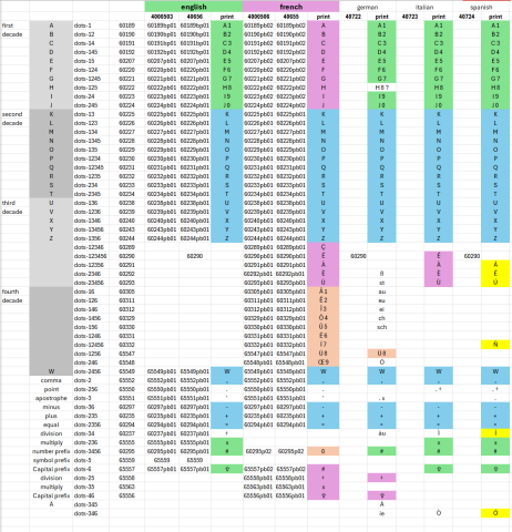

I've been trying to wrap my head around the LEGO braille bricks, and how we should describe them.
https://library.ldraw.org/tracker/33567
The inventory so far looks like this, but non of the sites have complete info yet.
It's pretty clear that we need to have some sort of standard here.
  • Where should the word "Braille" be placed?
  • How do we describe the physical stud pattern?
  • Should they all have their different language in the description? Many are common, and other are unique.
  • Should we include the Braille Unicode character?
  • How do we describe all the language specific letters, and symbols?
  • Keywords?
My suggestion is this:
"Brick 2 x 4 Braille [stud position] with [language] "[printed pattern]" Pattern"
Steffen suggested this, on 60198p01:
"Brick 2 x 4 with 1 Stud Braille Dots-1 ⠁ A 1"
Rene used this on 60198p01:
"Brick Braille 2 x 4 with 1 Stud (DOTS-1) with A1 Pattern"
