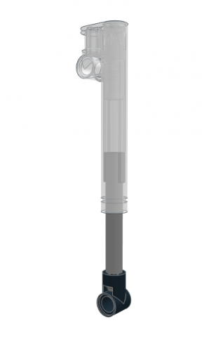

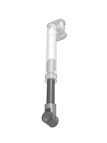

I was working on the set 42155 Batcycle, and I missed the absorber in correct colour. You can paint the body, but not the end part which "sticks" to the wheel. Here for example I painted it on dark pink, but the end is in lbg. The set 42155 has that part in black, not lbg. When I took the part 65151-f1 (or f2) I had to find a solution what to do.
.png   Zrzut ekranu 2023-10-11 210645.png (Size: 26.69 KB / Downloads: 47)
(ignore the unofficial parts, there are 65151c1-f1 and f2  I made)
In Ldview it is also lbg
So this is the reason why I wanted to submit a new part. I opened the part 65141c01 (absorber piston) in Parteditor and changed the colour to black. This new cylinder is now submited as 65141c02.
In part 65151-f1 (the original absorber with lbg end) I replaced the part 65141c01 (original cylinder) with 65141c02 I made.
The new competed abosrber I submited as 65151p01-f1(and f2) which is incorrect, because there is no any print - should be deleted, right?
I submited it again, now as 65151c01-f1 (and f2).

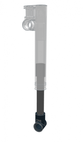

This is the part preview in Ldview and Ldcad:
.png   black absorber ldcad.png (Size: 26 KB / Downloads: 47)
And everything works, I used 65151c01-f1

So I opened my 65151c01-f1 in Parteditor, changed the part number from c01 to c02, part 65141c02 to 65141c01, and painted it black. Here is the actual result:
.png   65151c02f1 parteditor.png (Size: 16.42 KB / Downloads: 29)
(same for f2)
It looks correct in Ldview too

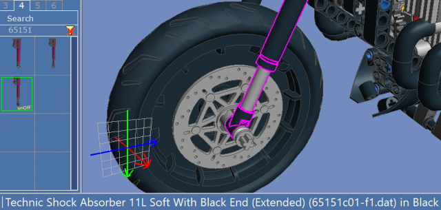

And I can search it in Ldcad
.png   ldcad search.png (Size: 9.32 KB / Downloads: 29)
Also I removed the part 65141c02 from my library
