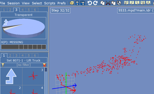

Hi, I'm trying to find help for my son. He uses LDcat v1.7 and from sometime we can see just small red "x" instead of Lego bricks. any thought how to change it?, thanks

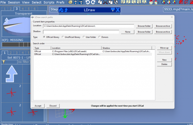

If you go to menu Prefs->LDraw->Search (library) paths…can you show us what that dialog window looks like?

(2023-09-28, 19:39)N. W. Perry Wrote: This means the program can't find the parts files in your LDraw library, and the most common reason is either that your LDraw library is corrupted or missing, or that LDCad isn't correctly configured on where to find it.
thanks for helping, this is how the search path looks like
Attached Files Thumbnail(s)

(2023-09-28, 19:45)jas kapela Wrote: this is how the search path looks like
It seems those search paths are wrong.
Resetting the configuration will fix it.
https://www.melkert.net/LDCad/faq#faq_cfgRst
Afterwards the program will ask where to find the library (or just complete.zip) at startup.
