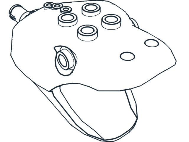

OK, so taking a SCREENSHOT looks like this:
[Image: tymjgqn72z1aked9g.jpg?size_id=4]
And exporting a SNAPSHOT looks like this:
[Image: tmo73rnzcssnnql9g.jpg]
The edge lines have disappeared (by "contour lines" I did mean edge lines, my bad for using the wrong term.)

I just found the problem...
Look at what a SMALLER SNAPSHOT outputs:
[Image: 1y7hua9i2qf14419g.jpg?size_id=5]
This is because the edge line thickness is not scaled along with the image export size.
I should have thought of it earlier...
Any way to fix this? Using maximum thickness isn't enough for my particular situation. I'm exporting very large images.
