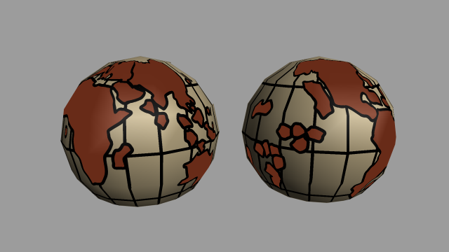

Hi all,
Is this part done?
Can the globe print be done trough texture mapping?
The part exists.
I am trying to make the image for mapping, but I am unsure how to map the image on the part.
Something like this (WIP)
[Image: 61287pb002.jpg]

I have no idea of what I'm doing but this works, sort of.
I used, and adapted the example from Travis below.
Something breaks around the northpole.

(2020-07-26, 16:09)Magnus Forsberg Wrote: I have no idea of what I'm doing but this works, sort of.
Would it render better if the surface was recreated using a sphe primitive?
What does the difference between concave and convex triangles mean for the final impression?
Why are the lines wobbling?

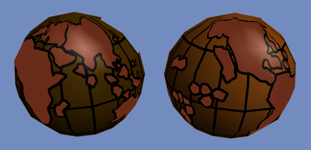

One problem with spherical mapping is that things go bad at the north and south poles. This isn't a problem on the bottom due to the fact that there's nothing at the south pole, but two polygons on top share the north pole as one of their vertices.
Another problem is that your image needs to be quite a bit taller than it currently is to work as a mercator projection. It seems like the image you have is roughly -80 to +80 latitude. If you change the the second 180 to 160 in the !TEXMAP line to reflect this, things get a bit better, but still not perfect (at least in LDView). I need to check to see if there is a bug in LDView. The top edge of the texture doesn't work well. Having said that, there is no way to apply two separate textures to the same geometry, so having a texture stop in the middle of a polygon leaves the rest of that polygon blank, and there's nothing you can do about that.
If the sphere geometry stopped at +80 degrees, and then a cone was used above that, a separate texture could be applied to the cone from above, and things would probably look pretty good. (Getting that texture to line up would take some work, but it would certainly be possible.) In that case, your existing texture would work great with a 160 degree vertical span.
I also tested by resizing your original image to be 1600 pixels tall, and just filling in the new space with the tan background (leaving the angle in the file set to 180). That actually improves things a lot, but the longitude lines then stop before the pole, and extending them up runs into the north pole discontinuity problem again.
As for the wiggly lines, I think that is caused by the fact that the spherical geometry is so low-resolution.

I definitely need help with the part. I can do the image.
Here is another test.
Definitely some strange things happening on the north pole.

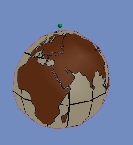

(2020-07-28, 14:14)Magnus Forsberg Wrote: I made two surfaces.
One based on a 4-8sphere primitive, and one replicating the globe/map, with longitudinal lines.
I think the logitudinal works best. May be that we should make a surface that completely match the black lines in the pattern?
Indeed I agree that 61287p01_longitude.dat will work best. I will do some testing again tomorrow!
But don't you think we should match the image, instead of the geometry?

(2020-07-28, 19:49)Jaco van der Molen Wrote: Indeed I agree that 61287p01_longitude.dat will work best. I will do some testing again tomorrow!
2 subfiles are now at the Part Tracker.
https://www.ldraw.org/cgi-bin/ptscan.cgi...escription
Attatched here is a file with correct position on the part and texmap.  It might still need some finetuning.
I've extended the printed surface to include some of the bottom. It is actually also printed.
Shouldn't the tan part of the image be transparent?

(2020-07-29, 12:32)Jaco van der Molen Wrote: What do we think of the images so far?
I like them alot.
But the pattern is offset. I think the equator line has to be in the center of the image, but I'm not sure.
And the whole grid has to be perfectly adjusted to the center of the image.
The "empty" half-square to the left and right has to be equally wide. And together they should have the same width as a whole square.
The bottom surface is at y=0. The northpole is at y=-46, but the equator is at y=-20
Should the image be cut to compensate for the missing south pole?
Wount the image be distorted if we choose another angle than 180° ?
The angle from the northpole, to the bottom of the surface in the subfile, is ~150°.
I can position the image by changing the texmap code, but isn't it better to have the grid in the image centered?

(2020-07-29, 12:49)Jaco van der Molen Wrote: I am not sure about the transparency of the image.
Compare with dark tan background left image (using the hex-color code for dark tan from ldconfig) and transparent right image.
Rendered with LDView in LPub3D
Above post features image rendered in LDCad with tan background.
This is transparent background in LDCad
If I modify the textures to be transparent, they look fine in LDView. I don't have the part, but I assume that the pattern is only present on the non-tan portions. Assuming that this is the case, then the textures should be transparent. I'm not sure why the LPub3D LDView rendering looks so bad.
Note that when I made the tan parts of your textures transparent, I was left with a faint tan halo around everything, although this wasn't really visible when it was applied to the part. If your source art is vector, you can regenerate the PNGs with transparent background instead of tan, and wouldn't have this problem. Or is that what generated the weird transparent screenshots you posted?
Can you upload the transparent version of the textures so I can investigate?
Reply

RE: Cylinder Hemisphere 61287pb002 and 61287pb001 (Earth map / Globe)
#22
(2020-07-30, 11:16)Jaco van der Molen Wrote: OK, my source files are vector so I can easily make the background transparent.
That is what I used when I rendered in LPub3D using LDView that came with LPub3D. I'll have to test with your normal version of LDView, but I am unsure that works in LPub3D. I do not have access to my laptop with the graphics program (I use Adobe Fireworks btw) nor the LDraw stuff, so I will update later today.
My daughter was so kind to give me some time on _my_ laptop, so I could upload transparent versions of the images in the Google folder: t-pb001.png and t-pb002.png =.
Where t stands for transparent, not tan. I have renamed the versions with background to dt-pb001.png and dt-pb001.png.
Next I tested and compare the two versions in LPub3D, LDView and LDcad.
Top globe is with transparent background, bottom is with dark tan background.
The strangest thing in LPub3D is that a certain area of the image is not rendered in every instance of the generated image.
LDCad does a very nice job rendering
LDView 4.3 did not render the textures and 4.2 crashed parsing the model.
Jaco van der Molen
lpub.binarybricks.nl
Reply

The one on the left is DkBrown, code 308
The one on the right is Reddish Brown, code 70
If the pattern is made using the same rgb code as Reddish Brown, why doesn't it look the same?
Reply
#32
(2021-02-06, 21:22)Magnus Forsberg Wrote: The one on the left is DkBrown, code 308
I'm not sure. Just to make sure I understand, you're saying that the texture uses the RGB for reddish brown, the oceans are transparent, and the underlying geometry is reddish brown?

(2021-02-07, 4:12)Travis Cobbs Wrote: I'm not sure. Just to make sure I understand, you're saying that the texture uses the RGB for reddish brown, the oceans are transparent, and the underlying geometry is reddish brown?
Correct. Screenshot from LDCad, not LDView. But I didn't make the texmap image.
https://forums.ldraw.org/thread-24419-po...l#pid40170
Reply
#34
(2021-02-07, 7:22)Magnus Forsberg Wrote: Correct. Screenshot from LDCad, not LDView. But I didn't make the texmap image.
In my LDConfig.ldr, color 70 (Reddish Brown) has a different RGB than the PNG texture. The RGB in the PNG for the brown part is #682b18. The RGB for Reddish Brown in LDConfig.ldr is #5F3109.
Reply
#35
(2021-02-07, 21:24)Travis Cobbs Wrote: In my LDConfig.ldr, color 70 (Reddish Brown) has a different RGB than the PNG texture. The RGB in the PNG for the brown part is #682b18. The RGB for Reddish Brown in LDConfig.ldr is #5F3109.
Also, if I edit the PNG for the texture to use #5F3109, the two colors look the same in LDView. (I don't have LDCad.)

(2021-02-07, 21:28)Travis Cobbs Wrote: Also, if I edit the PNG for the texture to use #5F3109, the two colors look the same in LDView. (I don't have LDCad.)
OK, I think I made a mistake coloring the landmass part.
What color is it anyway on the real part? Is it reddish brown?
I might have messed up the color with the many versions I did.

(2021-02-07, 21:37)Jaco van der Molen Wrote: What color is it anyway on the real part? Is it reddish brown?
That's the funny part of this issue. They both exist. Both DkBrown and Reddish Brown.
https://www.bricklink.com/v2/search.page...7pb00*#T=A
Reply

(2021-02-07, 22:38)Magnus Forsberg Wrote: That's the funny part of this issue. They both exist. Both DkBrown and Reddish Brown.
The RGB in the PNG doesn't match any current color in LDConfig.ldr. Also, it's further from dark brown than it is from reddish brown. So, while a separate texture would be needed for each color, if it really does match those colors then the current texture could simply be updated to match reddish brown, and a new one (p02?) can be created for dark brown.

(2021-02-08, 0:12)Travis Cobbs Wrote: The RGB in the PNG doesn't match any current color in LDConfig.ldr. Also, it's further from dark brown than it is from reddish brown. So, while a separate texture would be needed for each color, if it really does match those colors then the current texture could simply be updated to match reddish brown, and a new one (p02?) can be created for dark brown.
OK, I can easily make 2 versions png (or rather 4, 2 for each half and variant)
I'll use LDraw's Reddish Brown and Dark Brown values.

(2021-02-08, 7:01)Jaco van der Molen Wrote: OK, I can easily make 2 versions png (or rather 4, 2 for each half and variant)
I made new versions of the PNG's with the exact color for the landmass.
Reddish brown Hex #582A12 (RGB 88-42-18)
Dark brown Hex #352100 (RGB 53-33-00)
I am unsure how to submit and update these to the PT. At that point I am such a noob.... ;-)
