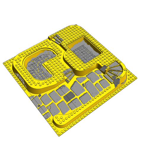

Glitches in both the image preview and the 3D render of https://www.ldraw.org/cgi-bin/ptdetail.c...092p01.dat
The preview shows thick yellowish lines around the edges of the texture images, and also has some odd vertical lines visible in the pits:

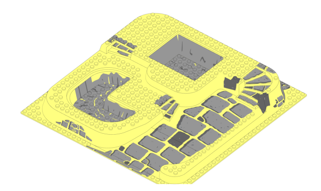

The 3D render is missing some textures entirely, and has distorted many of the others:

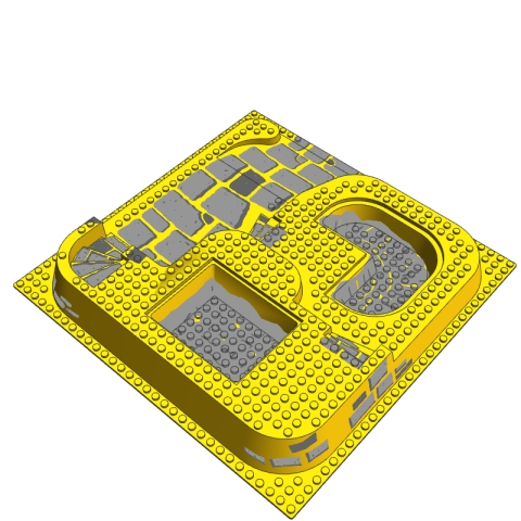

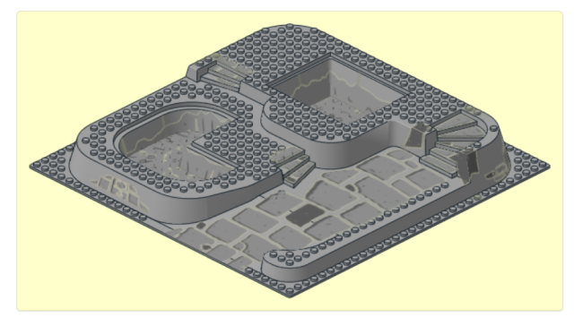

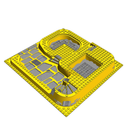

Here's some LDCad exports:

You seem to have fixed it all now. It does look a bit funky when loading the textures, but that is to be expected.
Your screenshots were also a great help when debugging.
