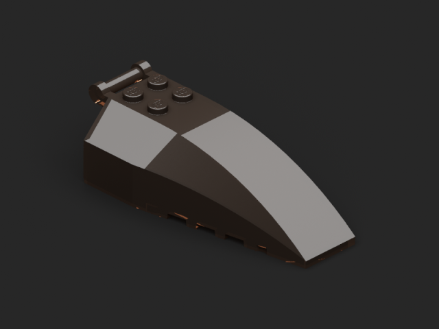

and after plenty of tweaking and testing, I have found a fairly satisfactory solution to transparent colors that approach the real thing. The scene in POV-Ray is setup with an area light and a white square floating above to simulate a studio lamp reflection. The part used is: 92579.dat, in Transparent Black (LDXColor40).

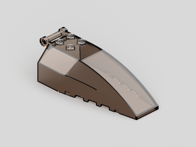

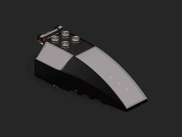

Here is the default values with dark and light surface as background:

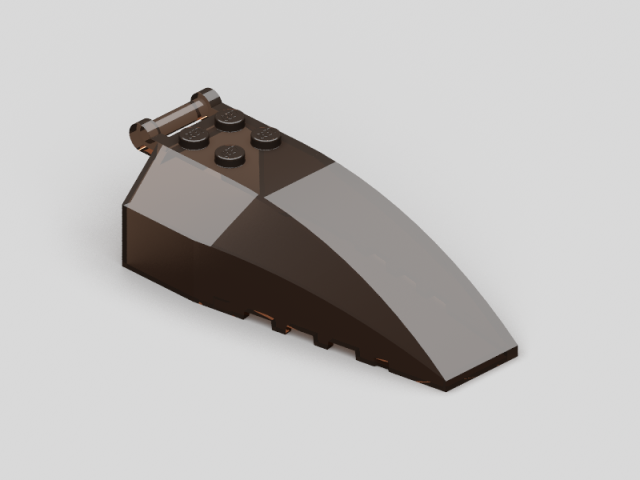

It is hard to see the internal edges or the surface through the transparency. Compare that to the fade_color version:
As you can see, the part is well defined and the edges are darker than the walls (as it should be), it works on both light and dark surfaces and allows you to see what is on the other side of the part. The only downside to using fade_color is that the studs are no longer colorize and appear simply as transparent. This seems to be due to the part not having an LGEO substitution.
My question to you good people is: Is there a way to apply this fade_color technique onto the studs so that they have the same color as the part itself, even without an LGEO substitution? I am not familiar with the whole Ldraw format, so any light you can cast my way (no pun intended) will be greatly appreciated.
