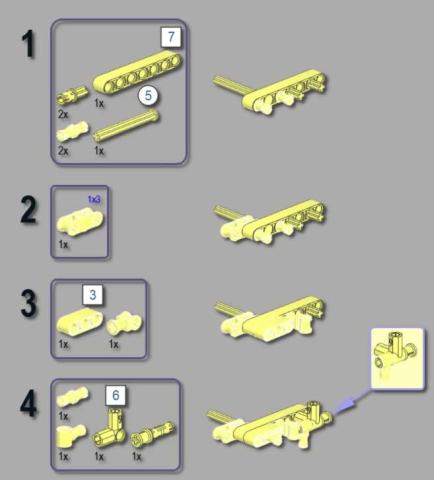

Hello everyone,
On the good advice of Philo, I have started to test the new renderer of Lpub3D 2.3.12 and in deed, it is very fast comparing to ldview.
Therefore I have started to work on a new model using this one.
But I have a problem regarding the size of the model, size of the callout and the pli. I have noticed that the scale is not longer use and is replace now by fov camera and distance camera) but I do not understand how to work with it properly.
For my example, I have set :
  • Fov assembly : 20
  • Distance : -270
  • Native factor : -270 (I have found a topic by Trevor which explain that -270 is A4 scale =1)
  • Fov pli : 30 (I want the part a bit smaller)
  • Distance pli : -270

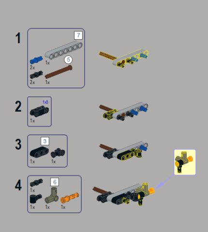

It works fine on the first step when the model is not too big, for instance :
[Image: 223E7cZ.png]
But I already noticed that the size of the assembly step by step changes, as the model goes bigger (with more parts), the camera seems to dezooming. You can see it comparing the first step and the 4th, I have not change anything, just add the step. You can see also that the callout is too big, with the same value.
When it becomes to be very complicated is when the model is bigger, for instance on this picture :
[Image: htbJjsR.png]
The mode is very small and the callout too big. So I want to change that but :
When I change the distance camera (for this step only), I have to put +400 to see the model in the page but the callout comes very very very big, so I change the distance camera for the callout but it did not work (lpub add the meta in the callout but then delete when it is regenerate).
So I change the fov for the callout but it do not work well (it changes the first step but not the second and sometimes make an error : image empty, check the fov to 30 default).
The other problem is when I change the distance camera for the assembly only in the step, when I comes to an other page, and go to the first one, the pli is very big (the whole page). So changing the distance factor is not a very good an reliable way.
I can change the fov on the assembly but I have to put 4 or less which tend to generate error.
So basically I want to set the size of the pli, set the size of the model (like the scale in ldview), by rendering the last step of the whole model. And for the first step when the model is smaller, play with the fov or distance.
It do not bother me that the camera auto zooming but this is pretty annoying of big step wich is too small and small step with is too big.
Therefore, If you have some clue or way to work with it, please tell me, I only want the proper way to work with it, because I think this new render is very interesting for rendering time. If I have to add meta on each step to have constant size or no problem, I will do. Or if I have a special configuration to do.
The most normal way to work for me, will that the camera not automatically zooming depending of the size of the model, in order the placement of the camera is only set by the fov and the distance, and if I want to zoom to see more or less, using the distance camera, but as I mentioned, it doesn't work like that. There are not many documentation of this new render and how to use.
Nicolas
ps : if you do not see the image, please tell me.

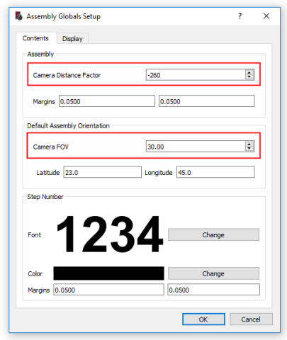

Quote:Regarding the default native seeting, I do not know how to set to default because I remenber that the factor was -260 at the begining, and you said -270 of the presentation post of the new render. So I do not know which number to make.
The correct default camera distance factor is -260.
You can confirm this by opening any model file that does not include a meta command that specifically redefines this camera attribute, for example, sample.ldr previously provided.
An example of the meta command that redefines all step assemblies to use -270 would look like this.
Code:
0 !LPUB ASSEM CAMERA_DISTANCE_NATIVE FACTOR GLOBAL -270

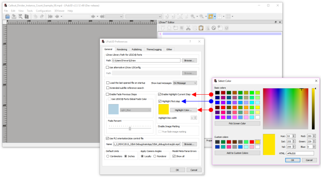

Once the model file is opened, you can see the default settings at Configuration->Build Instructions Setup...
For Assembly Setup... the dialogue would look like this for the Native renderer:
...and like this for LDView, LDGLite or POV-Ray:

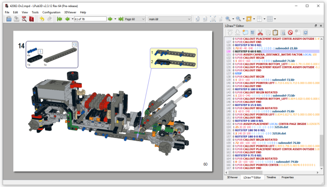

Quote:I have attached my file. You can see the problem on page 61 where I did not find how to deal with the difference of zoom.
Many thanks. Indeed, I do see the changes in size of the CSI. i will take a look on my side to see if this behaviour is automatic or related to your configuration settings. It would also be helpful to see your preferences settings as shown in this GitHub ticket.

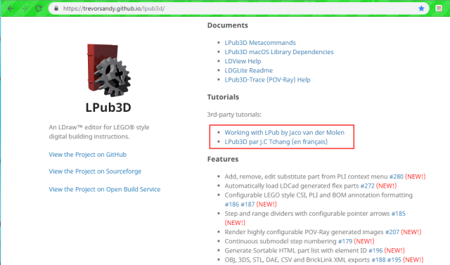

Quote:If you have a proper way to work (like a tutorial), I would humbly appreciated.
You can see the available tutorials from Help->Online manual or at the LPub3D GitHub Page, as shown below.
If I determine an update is required to achieve the expected behaviour, there is a pre-release Continuous Build at the LPub3D production repository. You can download the latest build for Windows (installed and portable distros), Linux AppImage, Ubuntu, Arch, Fedora and macOS platforms.
A continuous build pre-release exists when the Revision badge is greater than 0. At present the current revision for v2.3.12 is 49, you can also check if an update interesting for you is available from the list of recent commits (i.e. corrections) available at the Last Commit badge.

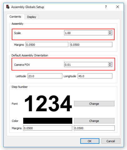

And when I go to the setup, I see that :
[Image: 4NCxLeY.jpg][Image: ekc1lvr.jpg]
Is this normal that the fov and distance on the setup changes ?

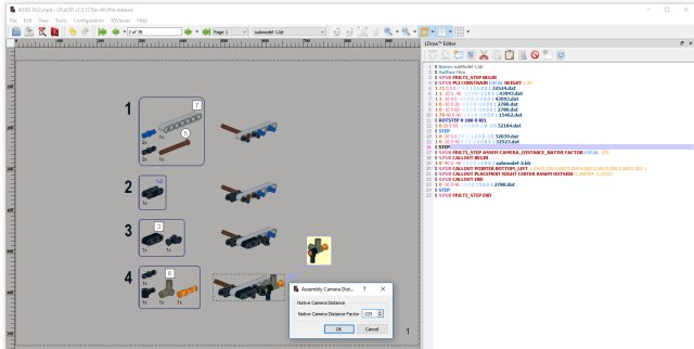

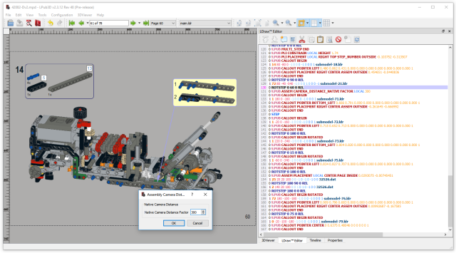

The only solution I found is to add this meta (example) to every step of a submodel that is in a callout to match the scale of the main model:
0 !LPUB ASSEM CAMERA_DISTANCE_NATIVE FACTOR LOCAL -370
So the default factor is -260. Decrease the local factor even more to match the scale. Perhaps you need to go lower then -370
Something like this in your model where submodel 72 is used on page 61
Code:
0 Name: subModel-72.ldr
0 Author: Nico
1 72 0 0 0 0 -1 0 1 0 0 0 0 1 41239.dat
1 1 -20 0 -120 -1 0 0 0 1 0 0 0 -1 6558.dat
1 1 -20 0 -80 -1 0 0 0 1 0 0 0 -1 6558.dat
1 1 0 0 -60 1 0 0 0 -1 0 0 0 -1 6558.dat
1 1 0 0 40 1 0 0 0 -1 0 0 0 -1 6558.dat
1 1 -20 0 -40 -1 0 0 0 1 0 0 0 -1 6558.dat
0 STEP
1 0 -20 0 -80 0 -1 0 1 0 0 0 0 1 32316.dat

I've performed an interim update to the camera position routines that treats the abnormal Callout and PLI sizes. You can download a DevOps continuous build to evaluate the new behaviour. See GitHub ticket #323 for full details.
Here are some shots from the update:

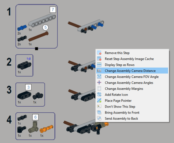

Correct. You can use the CSI and PLI context menu (right-click) or manually enter the meta command from the LDraw editor. Normally, you only need to update the Camera Distance Factor to zoom in/out the image when using the Native renderer. The camera angles will rotate the entire image accordingly and the FoV is more for advanced camera positioning. For LDView(POV-Ray) and LDGLite model scale is the only attribute that needs to be set manually but like the Native renderer, you have the option to edit camera angles and FOV also.
CSI assembly context menu for Native renderer:

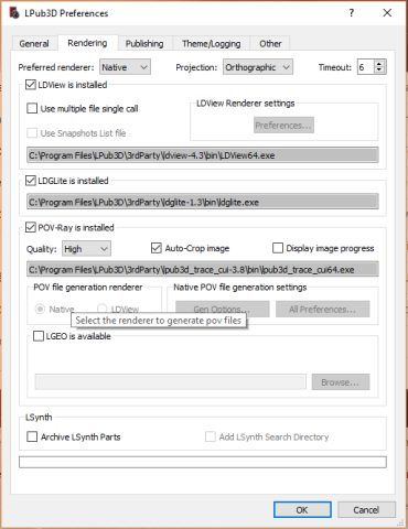

(2019-07-29, 9:10)Jaco van der Molen Wrote: This version of LPub3D renders like this?
@Jaco, are you referring to v2.3.12 r64 ?
Here is what I get with a fresh out of the box installation.
Cheers,
Reply
RE: Lpub3D 2.3.13 Native Render
#18
(2019-07-29, 9:40)Trevor Sandy Wrote: @Jaco, the Native renderer does have shading and lighting. You can see as such on Nico's step 14 shot in previous post. Look at the holes in the beams. Here's a shot showing the LPub3D preferences to tweak the shading.
Oops! Forgive my ignorance. I did not know this.
I did not expect to set this up in the 3D viewer prefs.
Jaco van der Molen
lpub.binarybricks.nl
Reply
#19
(2019-07-29, 9:56)Trevor Sandy Wrote: @Jaco, are you referring to v2.3.12 r64 ?
Yes. No installation but portable. Unzipped and loaded the file then render in all yellowish color (like color 16)
Only thing I put on is new part outline.
Jaco van der Molen
Reply

@Trevor : currenlty testing the new release and the new feature helps, I have set the size of my model on the last page, and then make the same for the step group which is consistent. There is still a autozoom but there is way better to control the size easily of all the elements. Thank you for your reactivity.
Reply
#21
(2019-07-29, 20:13)Nico71 Wrote: There is still a autozoom...
Excellent. Good to see you are progressing. The "autozoom" behaviour will persist for the Native renderer because the camera distance value is fixed. When the size of the image changes, the distance of the camera is not reset to maintain the image size relative to the page size, resolution, LDU, scale etc...
I expect the long term solution to dynamically adjust the camera distance.
Cheers,

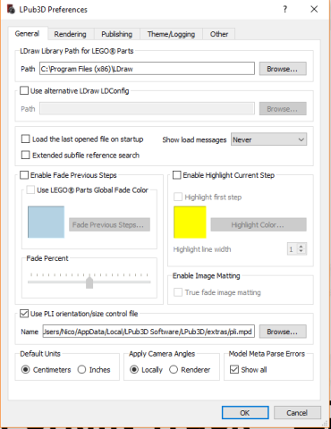

Quote:Is there also a way to have colored edge on new parts in a step ?
Yes.
Quote:...Like the highlight but only the edge and not the whole color of the parts ?
If this image shows what you're looking for when you say "highlight but only the edge and not the whole color of the part"
Then this is where you set the highlight next step configuration. The first step is highlighted when the flag pointed to by the blue arrow is set.
Note: The whole part should never be coloured by the highlight routines. The behavior reported by Jaco, where all parts were coloured yellowish, was an anomaly that occurred during my last update of the 3DViewer. However, this behaviour is available for Fade Previous Steps as you can see in the preferences picture.
Also, be sure to update your release if you're using a 2.3.12 revision between 40 and 48. If you are seeing fully colored images like the example shown earlier, reset your image cache by clicking the "Redraw" button on the LDraw Editor tab.
Cheers,
Reply

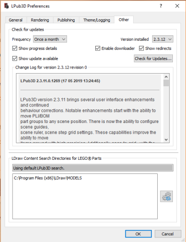

Quote:I am using the rev 64 download on github
Very well.
Be careful, your rev 64 is likely from the unstable DevOps repo (currently at rev 82) because I've only just now pushed rev 64 to 68 to the Production repo (currently at rev 68). My previous remarks about rev 40 to 48 referred to builds on the production repo.
Anyway. This behaviour...
Quote:As I said, it often appears when I made a callout or adding image of the submodel in the model.
is not normal and should not be occurring on production builds. Let me know if you are reproducing it with the latest production build ?
Cheers,
Reply

In deed I have test the highlight with the unstable Rev64 and it always get this  (even if I erase the Lpub folder).
[Image: DTTodaY.png]

(2019-08-02, 11:42)Nico71 Wrote: ...if I use the regular last build, I can not work on my instructions, right ?
This is not correct, you can work with the production build. I pushed the Native renderer correction to production in rev 52 on July 29 and the default colour fix was pushed in rev 54 on July 31. You could have used the production build since those dates.
