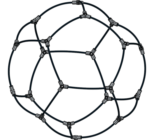

After seeing this in LEGO House: https://photos.app.goo.gl/bAAXaEebvrTMJfZZ6... I feeled urged to create a LDraw model!
I was too lazy to create a flexed axle template for LDCad so I used 12L rigid tubing instead, but it does the job!

Very cool, how did you get the positions of those axle joiners?

awesome.
I also wonder like Roland how you found the positions of the connectors in advance

Problem is not so much to get connector positions (dodecahedron vertices coordinates are known: https://en.wikipedia.org/wiki/Regular_do...oordinates), but to have them in the right orientation.
Here is the method I used:
- Get the distance between connectors. I used a visual method for that, placing two connectors with roughly the right orientation, then changing the distance until I got the desired length (96mm = 12L) for the flex part I put between them. Turns out the distance is 252 LDU.
- Calculate the radius r of the circumscribed sphere[url=https://en.wikipedia.org/wiki/Circumscribed_sphere][/url] (https://en.wikipedia.org/wiki/Regular_do...Dimensions): 353.117LDU.
- Because of symmetry, a connector must be tangent to this sphere. So I placed a connector at y=-353.117, above the middle of top face.
- Then calculate the angle I must turn that connector around origin to place it on one top pentagon vertex. We get alpha = arcsin(r1/r)=37.377° (r1 is radius of circumscribed circle of pentagon with side a = a/2/sin(36°) )
After that, it's only a matter of duplication, rotation by 72° around world Y axis and rotation by 120° around of Y local axis of already placed connectors...

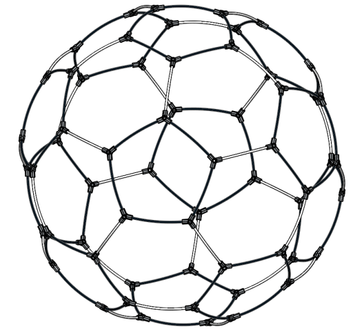

Using a similar method (a bit complicated because all edges are not equivalent) I also made a truncated icosahedron (soccer balls, geodesic domes, fullerenes, etc...). Enjoy!
