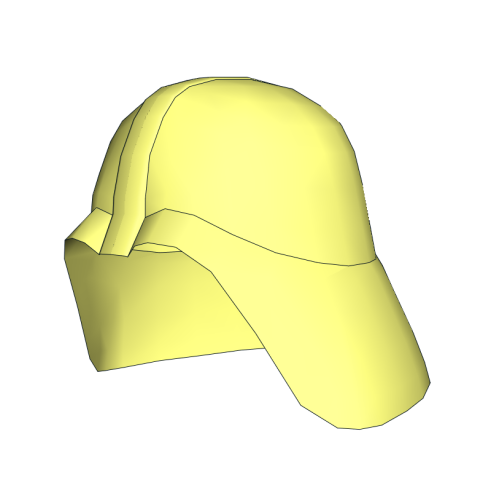

Some progress here! Done from flat templates created from photos in LPC, then sections built from them using pathtruder, then sections stitched and tuned in LDPE. Still missing an inside...

(2016-07-14, 14:01)Philippe Hurbain Wrote:
(2016-04-28, 6:56)Philippe Hurbain Wrote: I do have the helmet somewhere, but also a zillion things to do these time so... may be long. If someone else wants to give a try...??? Moreover shape is not simple and it's huge so won't fit easily my 3D scanner.
Cape may not be soooo hard. An image scan of the flattened cape would help.
Looks great allready.
Would it be possible to reuse this shape in all the different sized helmets?
I would love to see 22372 and 19916 made in the same time.
minifig scale
30368  (official part as 30368.dat, but a better shape is  present in LDD. IMO, it should be remade using LDD data. Paul Easter made a good atempt, but the top of that helmet is to long)
19916 + 19917
large figure
22372pb01
technic
43363

Now on PT!
http://www.ldraw.org/cgi-bin/ptdetail.cg.../43363.dat
