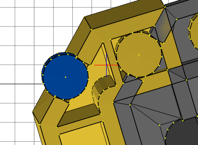

87620 - Brick 2 x 2 Facet
- The gap for the stud at the 45° section is too narrow.
I increased the size a bit:
Reply
