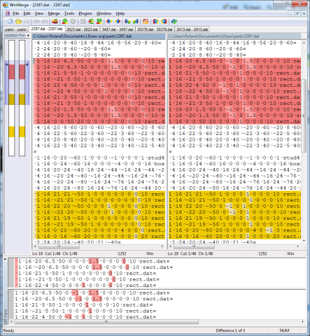

So I did a quick hack in the LDCad 1.4 code to make it possible to save corrected .dat files back to disk, this resulted in about 116 corrected .dat files.
Only downside I noticed is the loss of some indenting (only for the corrected lines, as LDCad preserves unmodified line content).
I also noticed some minor mixed dos/unix line endings which are indirectly auto corrected for any file that needed rewriting.
This test includes only 'hour glass quad' corrections, but with some additional tweaks I can also auto correct:

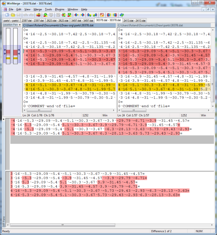

What's a normal minimal angle for splitting a quad anyway, I noticed for example 30378 has very weird quads (bow tie and non flat). Jet it seems LDView keeps them as quads anyway.
.png   nose.png (Size: 9.97 KB / Downloads: 9)
This (newer improved) version of my quad fixer uses ~18 deg (max 0.05 dotprod diff), but I'm wondering if it should be even lower.

Yes it should. According to spec, 3° is the maximum non-coplanarity.

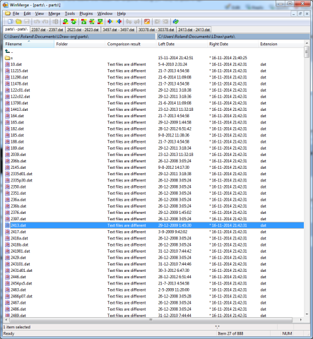

Ok I finished the changes, but it generated a 1000 files Smile
This seems to be mostly because of case mismatches though, I could leave those out if those are the only corrections in a file.
It also made me wonder about all the fuss about the auto corrections during loading as it took a release version of LDCad about 90 seconds to load and correct all 8193 parts (recursively) in the parts folder of the 1401 lib.
This taking into account loading 8000 parts (taking just below 1GB of memory) will probably never happen in a normal drawing session.
Anyone still interested in processing those files by hand?

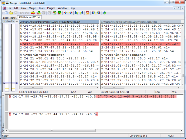

Quote:I'm not sure about "type 5 line with missing or duplicate control points (degrade to normal line)"
It really happens though, take for example this one:
Reply
Re: Auto correcting (some) defects in the official library
#13
Could you give us some example files?
Before and after fix?
Reply
#14
This might be easier to get the idea.
One side note, when I feed the corrected library again there will still be a couple of problems but loading the entiry library only generated about 65 warnings/errors, these are things like quads with multiple duplicate points, triangle with dup pnt, line with dup pnt, Those kinds of problems are not fixed and therefore currently also not saved.
I could do something like adding a 0 !INVALID in front of them, although it's probably easier for the reviewers to just follow the notes in the log file.

I've ran the last version of my tweaks on a clean 1401 library (re downloaded/installed complete.zip to be sure) and put all changed files in a
7MB 7zip file
The archive contains two lib root folders, one containing files whom only needed cap corrections and one with all the other auto fixed stuff.
I've also included the LDCad logfiles of the batch run for them both so you can check what was changed in detail, although I recommend using something like winmerge or svn to detect / inspect the changes.
Finally there is also a log file of a batch run on the already corrected library which shows the 'fatal' errors which remain in a couple of dozen files.
I'm not in anyway suggesting these files should be bluntly put into the part tracker as they might need human intervention adjustments in some cases.
Anyway here you go Smile

Magnus Forsberg Wrote:What are the errors you have fixed?
These are the things whom are detected and fixed during loading of LDCad and thus end up in these patches.
  • "0 BFC CERTIFY INVERTNEXT" -> "0 BFC INVERTNEXT"
  • type 1 ref name case mismatch
  • all zero matrix in type 1 line -> id matrix
  • all zero row or col in type 1 line matrix -> tries to correct by adding 1 or -1 at suitable position.
  • type 1 line with color 24 -> color 16
  • type 4 line with hourglass sequence, tries to fix by swapping/rotating points around
  • type 4 line with duplicate points -> degrades to triangle (but only if the other 3 are unique).
  • non flat type 4 line (0.0015 dotprod diff -> ~3deg) -> degrades to two type 3 lines.
  • type 5 line using a control point which is equal to one of it's line points -> degrade to type 2 line.
Most made corrections are the case mismatch, the hourglass or non flat quads though. But all these corrections where added to LDCad because it caused problems in one way or another at some point (in the past).
