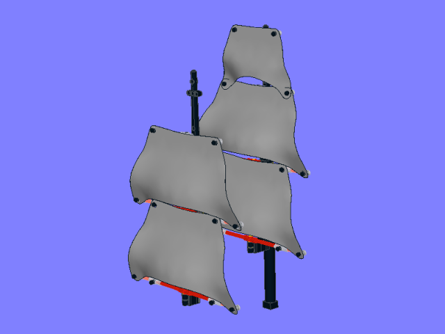

I made this, as a visual help, while reviewing these sails.
The shaped sails are still unofficial and need more reviews.

In the meantime, I've tried to do it with CATIA, this is what I got so far:
[Image: CATIA_V5_test_CATProduct.png]
Maybe it will be easier for patterning than with MeshMixer. I don't know yet.

The best tool is the one you know how to use - if Catia works for you it's probably the best solution! Attached what I got using MM...

Great job, but as you might have seen, the distortion on the holes is quite large.
You're right, I think I will stick with CATIA.
I've posted the unformed version here.
