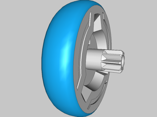

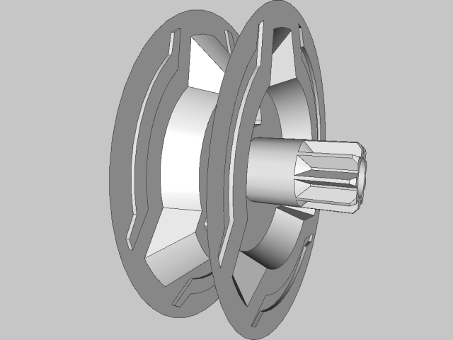

Hallo,
after a little while I worked on a hi-res version of 11140 as recommended by Santeri Piippo which renders much more beautiful than my previous one.
But before I upload my parts one more question: do I have to model the outer cylinder of this wheel? It will never be visible, apart from that I don't know the shape of the wheel under the rubber. Same question for the axlehole: you never will see it in the complete part 11767, so do I have to model it? Please see the 2 pics.
regards, Ingolf

#11
Someone else can correct me if I'm wrong, but I believe that "needs work" would apply to this case where you don't know what the geometry looks like under the tire. Please read the text describing "needs work" in the linked spec.

#12
Yes, you should attempt to fill in the outer rim, and yes you should model the axle hole.
It doesn't seem too difficult to see the profile of the groove by prising up the rubber tyre, as it is not glued on. But I can understand if you don't want to do that. The matching inside of the tyre has the same profile, and should also be modeled as a closed surface.

#13
Chris Dee Wrote:Yes, you should attempt to fill in the outer rim, and yes you should model the axle hole.
...well, I didn't even consider it. And I was quite surprised how easy it was Smile
But did you manage to remove the axle? I tried as well but wasn't succesful.
Ingolf
