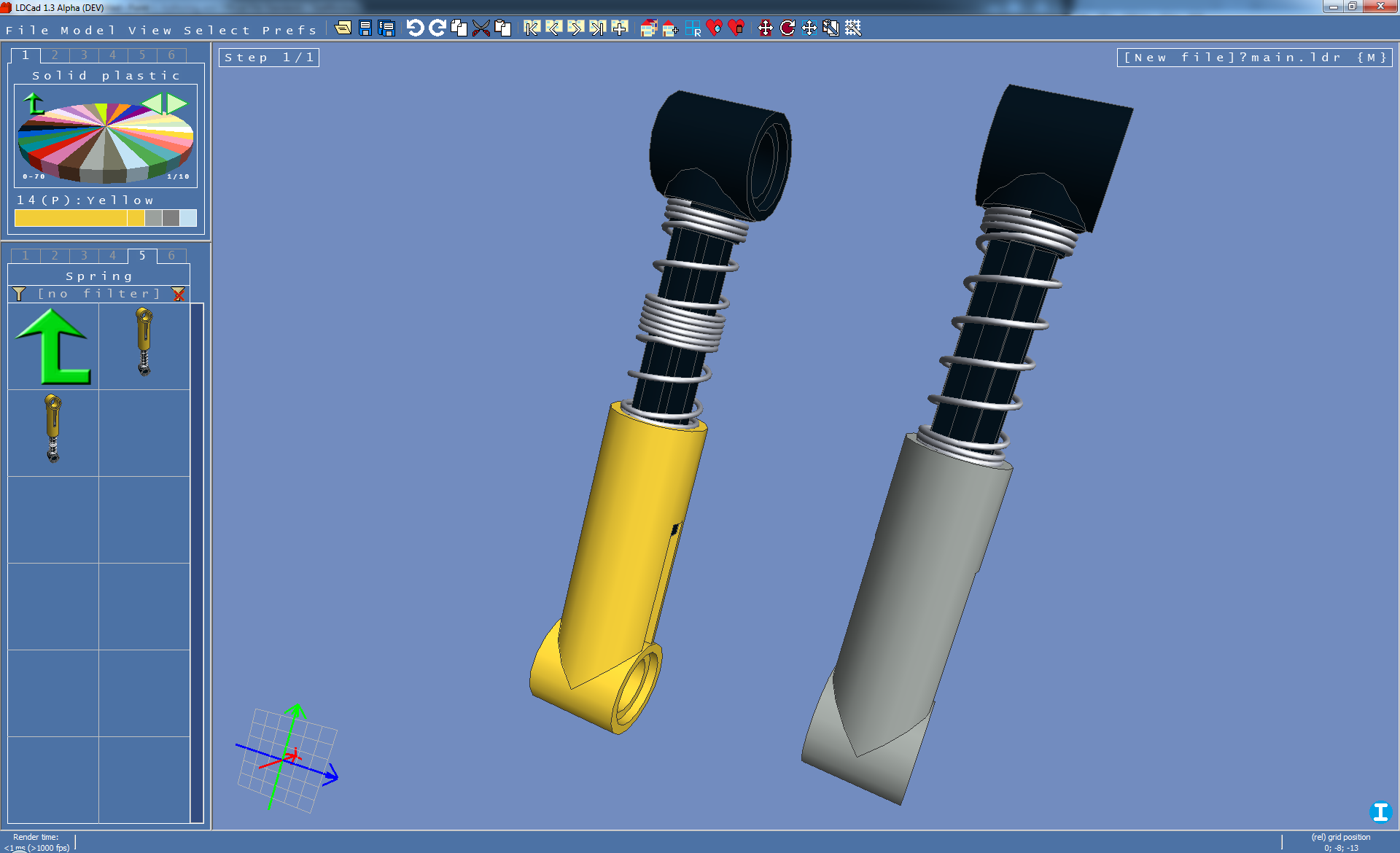

Hi I'm working on a spring generator for LDCad, and was wondering how far I should take the details.
I've looked at the existing springs in the library, and noticed they don't have conditional lines in the way I would expect them. They also use static lines around the (very low res) wire edges.
Is this on purpose or pure some performance issue ?
Anyway this is what my current code generates (no lines at all).
[Image: springs.png]

Well, the springs are mostly done by the spring generator which is included in MLCad. And therefore there are no lines at all.
However, I don't like this behavior. I like complete part WITH all lines. See discussion at this (sub-)part s/70181s00.dat
The shape of your springs is incredible. I really like it.
/Max

My opinion is that simplest is best, for performance reasons. You can't see the small details at this scale. Anyway, your rendering looks excellent!

I can see how file size might become a problem, these test renderings are already using 5000 triangles (or 2500 quads, but I'm not sure they are all flat).
OpenGL wise this isn't a problem, but when I add the wire endings and all conditional lines you are looking at ~15000 LDraw lines Smile Maybe I need to (optional) dial down the resolution for the LDraw output.

Ok I've added conditional lines.
Attached are two samples. I would appreciate it very much, if someone would take a look at them from a part author's point of view.
Personally I think ~0.5 MB for a spring/shock part isn't that bad. This is using a resolution of 16 for the coil and 8 for the wire.

The only issue I can find is incorrect use of colour 80 on a metal part.
All metal parts, like axles, screws, electric contact plates, plugs and springs, must use colour 494.
And why don't you use standard edge colour 24?

Generally I am fine with the result. But the question for edgeline colour is a good question. I have changed the colour to value 24 and it still looks goods. I feared that it would be only all black, but that occur only if I go far far away.

If you give the spring color 16 it will use 24 for edges, but because I wanted the shock to be yellow or grey (old/modern version) I made those color 16, and you can have only one parent color. This means the spring is drawn using normal colors because far as I know you can't say 'edge color of 80'. The current solution for this is encoding the edge color of color 80 in a rgb color code.
Alternative is to split the spring from the shock but this way people need only one separate file/template which is way easier to manage for me code wise.
Users are still free to flip the color code's around off course it's all gui controlled.
And as for the loose spring, I just forgot to set it to 16 Smile

The color problem you mentioned only occurs if you put the spring directly into the assembly.
The assembly uses color 16 for coloring the plastic parts, and there color 24 will properly be used to colorize their edges.
However, if you generate your spring DIRECTLY inside that assembly file, using color 494 for the spring quads/triangles,
and color 24 for the spring edges, then of course it will get the wrong edge color.
Your tool in this regards is somewhat wrongly using our files structure!:
The spring should not be generated directly inside the assembly file.
IF you would instead generate it in a way in which it REPLACES the spring part completely,
then your generated spring can use colors 16 and 24 as usual, and would be referenced from
the parent assembly as color 494.
Then everything would appear with correct colors.
May I suggest to modify the generator of your tool this way?
The "trick" of hardcoding the edge color using an RGB value is counterproductive IMHO.

Indeed, but the user is totally free to create a loose col 16 spring and reference it from another submodel. But I like to supply the user with complete shock absorber assemblies using templates. Due to a technical limitation my generating code (heavily shared with the flexible (pneumatic etc) generator) can only handle a single submodel containing the fallback code (LDCad it self doesn't use the type 1...5 lines of the spring model).
This has been bothering me somewhat since I created the flexsystem cable templates in LDCad 1.2 (which is a two color bendable part). So I have been thinking on a way to generate multiple fallback submodels while ignoring those in LDCad it self using a 'skip next file' meta or something. Other software will not skip that and thus show the part as intended using multiple submodels.

Ok it took some doing but I've implemented support for this. It will no put the spring 'mesh' into a second subfile when it's not of color 16. See attachment.
Now I only need the exact measurements of the common springs (wire thickness, etc), does anyone have these handy?
