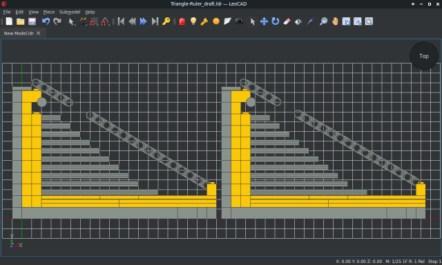

"Triangle Ruler" brick (from 852690 and 852759 sets) dimensions are constrained with bricks dimensions.
Here are some useful references and photos:
Attached LDraw file includes a mockup with two variants: one for 31deg/59deg and 60deg/30deg.
  1. Grey Bricks defines boundary of the part;
  2. Yellow Bricks defines the part shape (but not the thickness of the Triangle Ruler).
  3. Grey Axles defines location of half-thickness slots (slots are a bit wider than axles diameter);
  4. Large Beam defines angled side/slope of triangle and the end of the slot for beam parts measuring;
  5. Small Beam used to check cut ontop of triangle (see reference photos);
  6. Round Tile defines the centre of round hole, but not the diameter.
