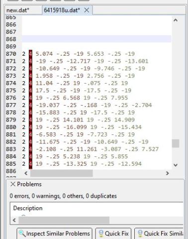

Yes, over 100
"* Beside flagging the T-Junk unfortunately Edger found also these:
2 4 12.6546 -.25 10.97567 9.681098 -.25 10.45317
2 4 9.662098 -.25 10.46267 12.6546 -.25 10.97567
2 4 9.681098 -.25 10.45317 6.707598 -.25 9.864167
2 4 6.707598 -.25 9.864167 9.662098 -.25 10.46267"

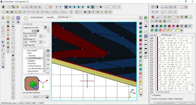

Okay, but I can't find them
"* Zooming in very closely you'll see that there is a gap."

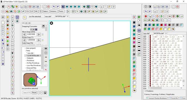

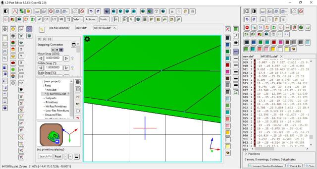

No, I don't see any gap, maybe because it is too dark or too small. Here I preview it in red/green surfaces, maximum zoom. In normal view it is also not visible
"* Select Line Size 0 to hid the red edges and see shining through the 16 - Main Color bottom of the sticker. Switch to BFC view mode to see the red among the green quads."
Ok so in size 1 it is visible

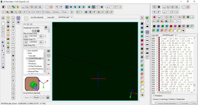

Select 0 - ok, hidden. But where is the shining?
Maybe bottom view? Nope
BFC view? Also nothing, from all sides, and not even in maximum zoom (see it before)
So I can't select the vertices to merge them
