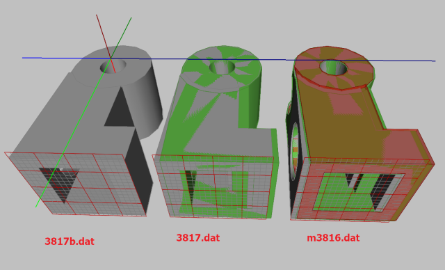

It all started with an incorrect assumption from me. I claimed that the footprint of the minifig leg should be inline with the hipstud in 3815.
https://forums.ldraw.org/thread-18102-post-18119.html#pid18119
Nils made a new leg based on that assumption, 3817b.dat
Chris and I reworked most of the patterned parts, and they have been made official.
The only downside was a strange slope on the backside of the leg. Hm....

Notice the offset of the centre line through the foot.
This would mean that we have to redesign the leg again. The foot has to be moved 1 ldu forward. The foot should be moved, and the front of the leg, but not the shape and surface of the hip.
The easy way out of this is to revert back to the old design, 3816.dat,  but....

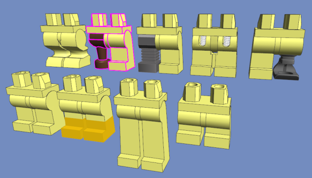

What should we do about all the legs that have been derived from the leg with the incorrect sloping backside?
Faun leg, Pirate leg, Robot leg, Springed leg and the Prostethic leg, and the Dual moulded leg and the Long leg and the Medium leg.
