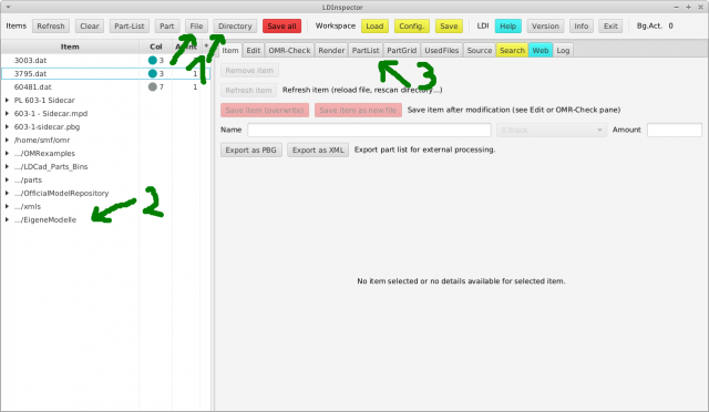

LDInspector way with GUI (needs Java>=11+JavaFX):
1. add files/directory
2. select first file to compare
3. choose PartList tab

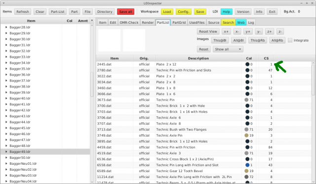

4. right click "CS" column header to "Copy row" ==> your first file is now in CS and C1

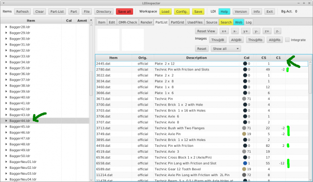

5. select next file
6.1. manual way: compare CS and C1 directly
6.2. automatic way: right click "C1" column header to "Subtract CS amounts from this row" ==> in C1 is the difference
