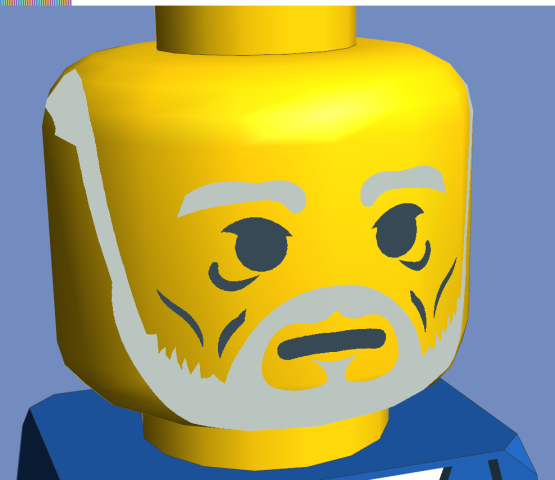

First test result:
Source mpd attached.
This projects the ldr given in !TEXMAP onto a tight fitting 1280x1280 texture. And then use it like any normal TEXMAP texture.
The final version has to do (Way) more with dimensions and positioning, but I was thinking this is a nice little proof of concept already?
