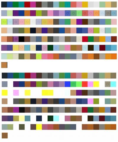

Hello, I loaded Lego models into LDView 4.3 and exported them as POV-Ray files. I noticed that some colors are displayed incorrectly in POV-Ray. I haven't found a way to adjust the colors. In the following picture, the output of LDView can be seen in the upper part, saved as a PNG file, and in the lower part the representation in PovRay. There are particularly large deviations in the transparent colors. Am I doing something wrong or how can I adjust the colors?

(2020-12-09, 22:59)Manfred Schäfer Wrote: Hello, I loaded Lego models into LDView 4.3 and exported them as POV-Ray files. I noticed that some colors are displayed incorrectly in POV-Ray. I haven't found a way to adjust the colors. In the following picture, the output of LDView can be seen in the upper part, saved as a PNG file, and in the lower part the representation in PovRay. There are particularly large deviations in the transparent colors. Am I doing something wrong or how can I adjust the colors?
Do you have LGEO enabled for your POV export? If not, LDView should generate all the colors and have them have the same RGB as it uses internally. If so, though, it will use the LGEO colors defined in LGEO.xml, which might not match the current LDConfig.ldr file that defines LDraw colors.
Sorry it took so long, but I finally think I figured out what is wrong. I think that the problem is caused by a difference in the way that POVRay treats colors in POVRay 3.7 and later. So I came up with a fix that I only activate if you tell LDView that you are exporting for POVRay 3.7 or later. Let me know what platform to build for (Windows 32-bit, Windows 64-bit, macOS), and I'll PM you with a link to a test build with a fix that you can test. (Note: if you need a Qt version, it will have to wait for the next Beta release.)
I also discovered that colors that have some transparency, but aren't "transparent LEGO" (like glow-in-the-dark) weren't working right either. I also attempted to fix those.
